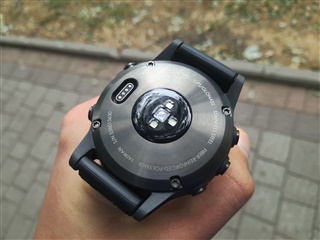

Hi guys,
I just got a brand new replacement for my Fenix 5, but I believe it's an old production unit, since it has a 7 months old firmware (12.40) and the silver pins like the other one.
I'm expecting the same issue I had before in the next weeks or months, so how is yours holding up? I read about people asking for 2 or more replacement after just some weeks.
Also, any news on how to prevent this to happens?
edit: old serial was 5361xxxxx, new one is 5363xxxxx

  • Your pin looks perfect to me, are you sure it wasn’t just some dirty stuff?
    Sometimes it looks like rust, but it’s not. On my old watch and others I saw there was a very recognizable wear and tear of the pin.
    btw I have the suspect that leaving the pin dirty during the charge can cause the problem.
