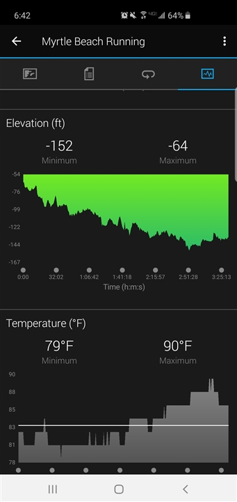

I have v14.10 on my watch which is a fenix 5s and I have tried to recalibrate the altimeter and I have the same results on my run
. Apparently it believes I am 200ft below sea level. I have yesterdays and today's elevation graphs posted.
I have the same thing but when wearing the Garmin Run HR monitor.
I am still having this problem. I have tried to reset the altimeter before each run and it looks correct when I start but immediately goes incorrect after I start. I do not have auto calibrate on that gave me worse results. Does anyone have a fix? My watch is up to date on 14.20 and GPS 2.50. Thanks for any help.
Obvious question: Is your port clean? Do you wash the watch regularly, or preferably shower with it?
Yes I wear it in the shower so the port should be clean. This was today's run. This was after I calibrated it this morning prior to starting the run.
If a factory reset doesn't help, I'd reach directly to support.
