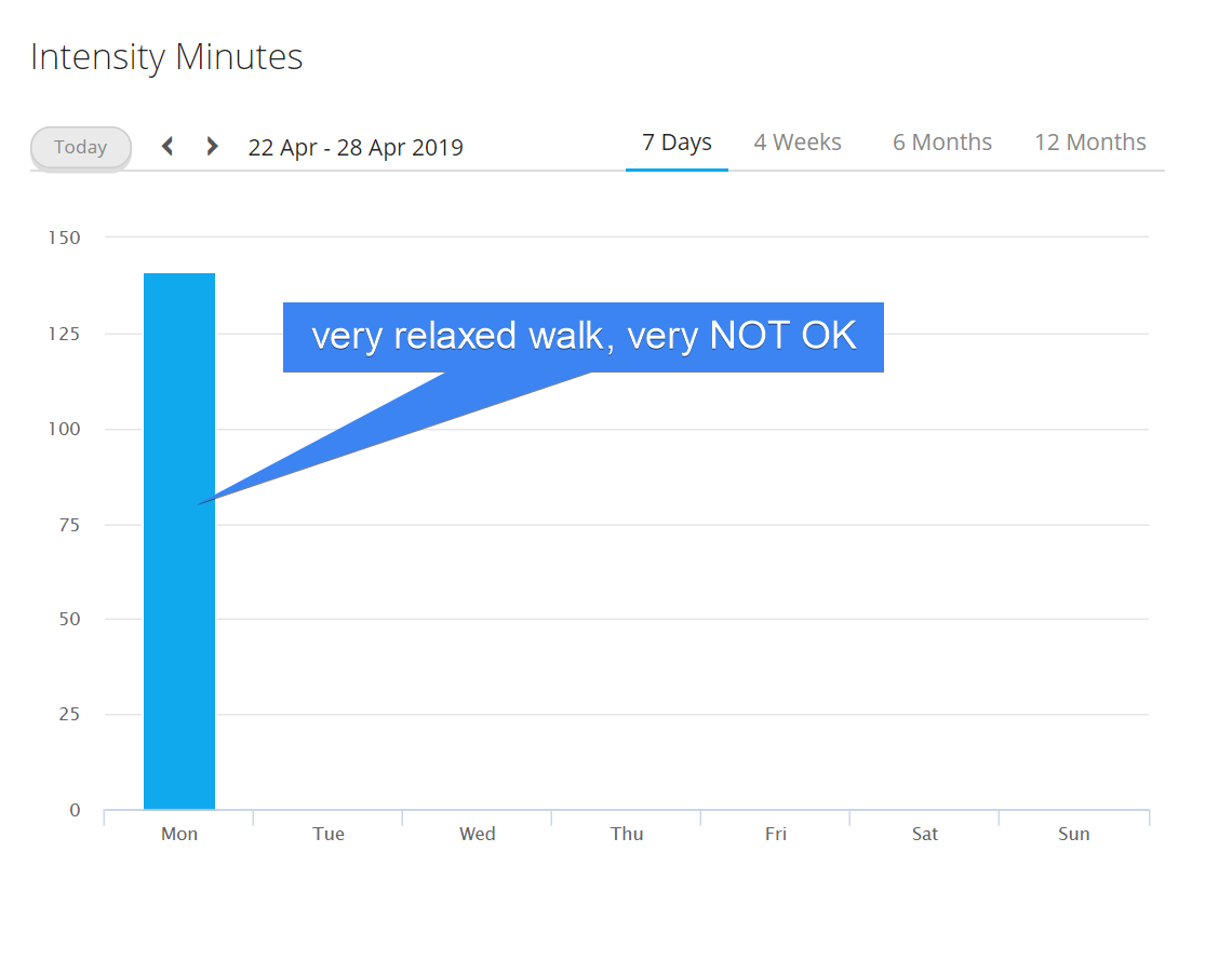

  • Well there is something else... take a look at this new observation - this was just a very lazy walk during 1h and when I checked my HR it was over 170! See the photo and the Garmin Connect screenshot from the same walk (also note MoveIQ detected it as a "walk" as it should).
    So I restarted the device and then HR became 85, which is realistic.
    Please help.
    Let me know if I need to send any extra info, debug info etc... I'm really disappointed that I can't rely on HR or Intensity minutes anymore...ciq.forums.garmin.com/.../1476101.png
