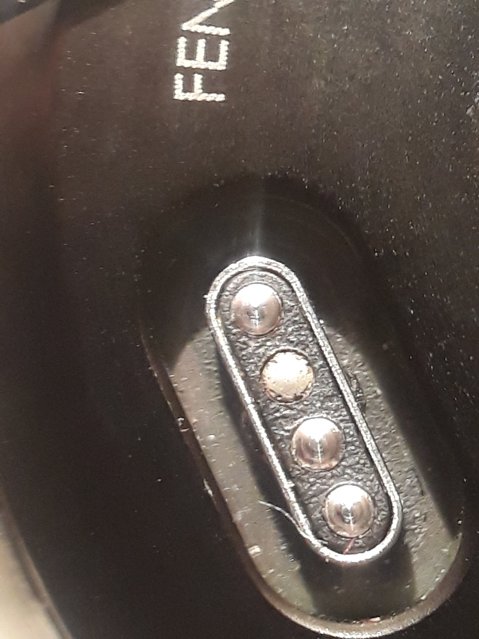

Hi, I have a Fenix 5 (slate grey) from September 2018, so just around six months old.
It has become a bit fiddly with regards to getting a good connection on the port. Took a peek and it seemed like there was some dirt on the connector. Wiped it down, still there. So grabbed a macro camera and took a closer look.
Seems like my connector is quite corroded! Have any of you had the same issue? ciq.forums.garmin.com/.../1465898.jpg ciq.forums.garmin.com/.../1465899.jpg

    Same problem here. I bought it in august 2018, and I noticed the rust 2 weeks ago on the second pin, I cleaned it with isopropilic alcool and almost all rust is gone, but on that contact pin it can be noticed that it has some craters where was rust. Unfortunately I dont have Garmin customer suport in my country so I hope it wont get worse.

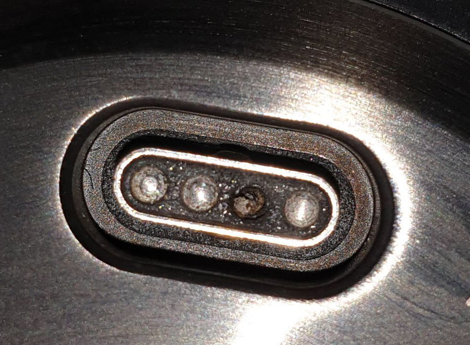

    strange thing with this second connector, most of the people in this topic have problems with the same connector. here's how mine looks, after not full 4 month use, I'd say pretty big damage already. probably be trying to replace it.ciq.forums.garmin.com/.../1472764.jpg

  • Same problem here with less than one year of usage... It still charges, but the pin has almost disappeared :S
    I've just sent an email to Garmin Support (Spain), will keep you updated about their answer.ciq.forums.garmin.com/.../1475499.jpg
