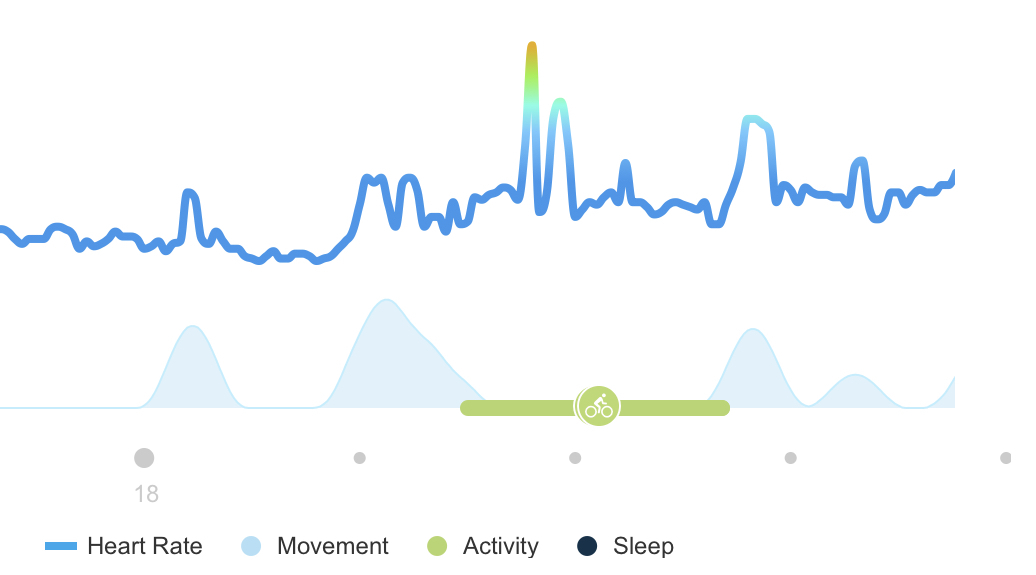

F5 records HR throughout the day and although I can’t be 100%, data looks ok. If I start exercising (indoor bike) *without* starting an activity and look at it after exercise, the HR is out by us to 70beats! I know this as I wear an external Garmin HR-TRI and record to various apps and also to Garmin Edge 1030.
What is really interesting is if I select the HR widget on the F5 whilst exercising the HR shots up to the correct HR on the display and is recorded correct, but once the widget times out and goes back to Watch face it reverts to a much lower and incorrect value.
See the attached picture the spike is when I selected the widget.
Any thoughts? ciq.forums.garmin.com/.../1444897.jpg
  • There are a number of factors here:
    1. The OHR samples less frequently in 24/7 mode than it does in exercise mode. It also samples more frequently with the HR graph activated. Peek under your watch and look at the LED's to see this happening.
    3. The all-day graph high and low numbers report what has been sustained for 60 seconds. While the Edge with a chest strap (or even if you just re-broadcast your watch's OHR) will report the highest and lowest instantaneous HR. So if your HR is 100, then you do a short 15s interval and your HR rises to 120, then drops back to 100, the all day graph will show just 100, as this is the maximum that was sustained for 60s.
    2. It is widely acknowledged that OHR is less responsive to sharp changes in HR than chest straps, so it probably will miss sharp peaks that will be picked up by the HRM-TRI.
    70 beats sounds pretty high for a difference, but I suspect that I could generate such an example with a sprint effort from a standing start.

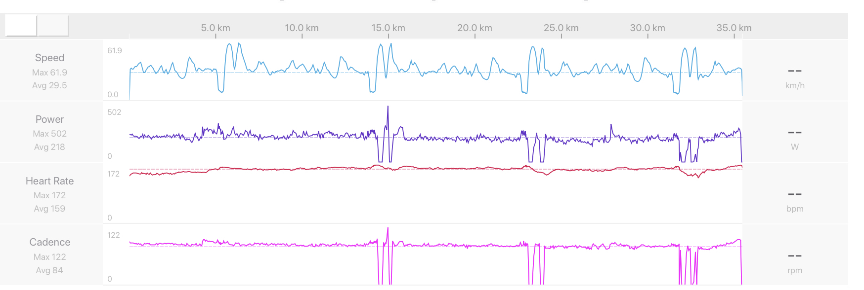

    1. I realise that the samples would be less frequent, but the cycle ride used as an example was for over an hour and averaged at 159 so don’t believe it is sampling rate.
    2&3. Again it was a race situation, not intervals. (See data from HRM-TRI below)
    It seems like OHR being incorrectly recorded when exercise started (F5 auto identifies activity rather than me explicitly starting it) until I select HR widget (and only whilst active) or (unlikely) widget picks in HRM-TRI HR when in the widget.
    i will try later to start manually Activity with OHR recording and see if it records correctly.
    Thanks
    Shaw
    ciq.forums.garmin.com/.../1445459.jpg
