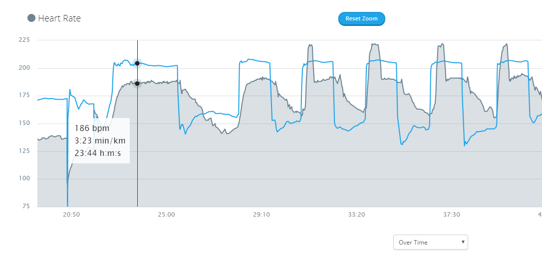

Using Garmin Fenix 5X with HRM run 4 (and also tried a HRM Tri), when doing interval / tempo trainings, I have spikes of HR.
Running on a track and doing series of 400m or 800m or so, I do series at around 180-185bpm of real HR and have spikes up to 225bpm!
Sometimes it happens at the beginning of each interval. Jumping from 140 to 210 and then stabilize at the correct 180.
Sometimes it happens after 1-2mn of effort and stay incorrect until the end of the serie.
Sometimes I have up-down-up-down from 180-210-180-210 during the same serie.

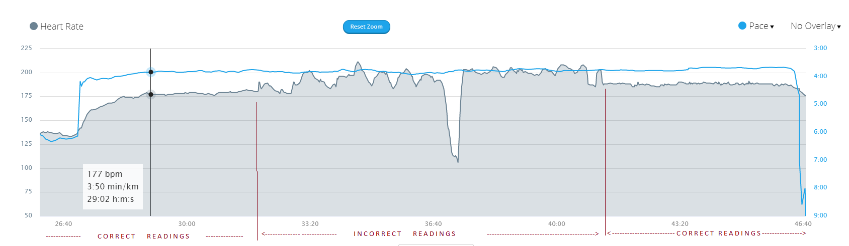

And I also experimented big drops when doing high intensity for longer period (during race and race simulation).
I'll have the reading dropping at 110 for 1 minute or 2 and go back to 180.

I am attaching 2 examples with a 5KM run showing 10mn of completely innacurrate data for a workout of 20mn!!
And a beautiful interval training showing the HR of a new born at each acceleration.
