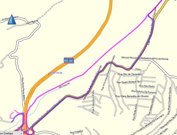

    In my case we got a flood blocking our course and had to detour following the blue track instead of the original purple.
    Something like 2,5km till returning to original track.ciq.forums.garmin.com/.../1422185.jpg

    I don't know about "resuming later" but in my case, fw 11.0.0.0 does loose the course points warning cue sheet (navigation step by step "TBT") if you get off course for some time showing the distance only to "end point".
    Yes, it was a loop. Although the start and end point of the course were not the same, at some point near the start they start and end approach hikes crossed one another at one point, so it was a loop. Come to think of it the last time I had this issue it was a loop also. However, I find that in general in the latest versions of the GPS firmware that if you deviate from the course and go back to it at a later point (such as the example above by marcossaad) it takes much longer than before for the GPS to recognize that you are back on the course.
