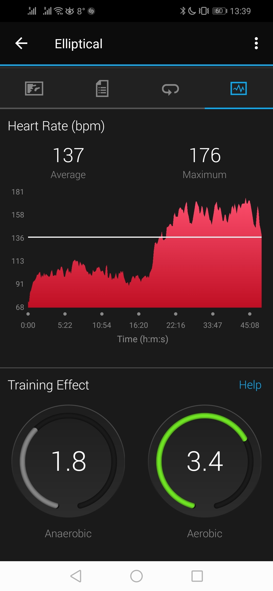

    Here is a screenshot from 31/10/2017 last year, around same ambient temperature, same arm same hair on arm density, same skin color. But do you know whats diffrent its the device last year I was wearing a vivosmart HR which I never had an issue with.
    I think when you buy a cheaper device from garmin that have less features most of your money goes to little features you have. But when you buy a more expensive device the money get distributed on the gazillion features that you end up with a worse device than the cheaper one
    Free advice to garmin :
    When you develop a new device just focus on the HR thats where your bread and butter espcially when all of the important reading that the user wants are based on HR like calories and hr zones.
    I dont care about watch faces, elevation barometer altimeter or even 1 hour till sunset.feature .
    Remember less for more.
