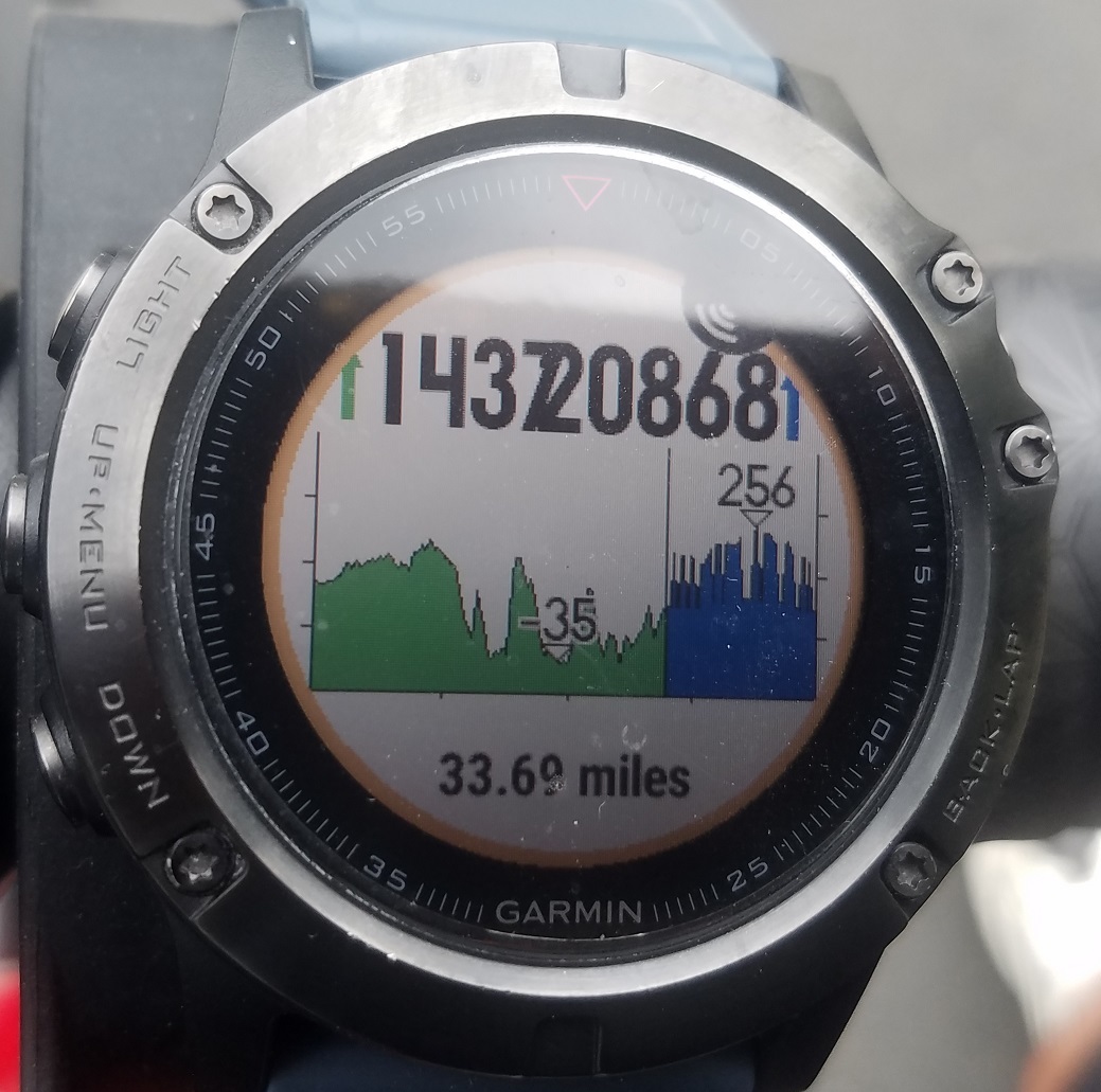

  • Please fix the elevation screen numerical ad it is garbled. The elev completed vs remaining merge and seem wrong. See image.
    Also, regarding the auto climb screen, please have the watch return to the screen it was at prior to the climb instead of always returning to screen 1. If i have the map screen on when nav a course, every time there is a climb the climb screen goes on and then returns me to screen 1. I need took then manually flip screens to the map screen. This is a pain. The auto climb screen should be treated like all your alert screens, you show them, then you return to the screen that was displayed prior to the alert.
