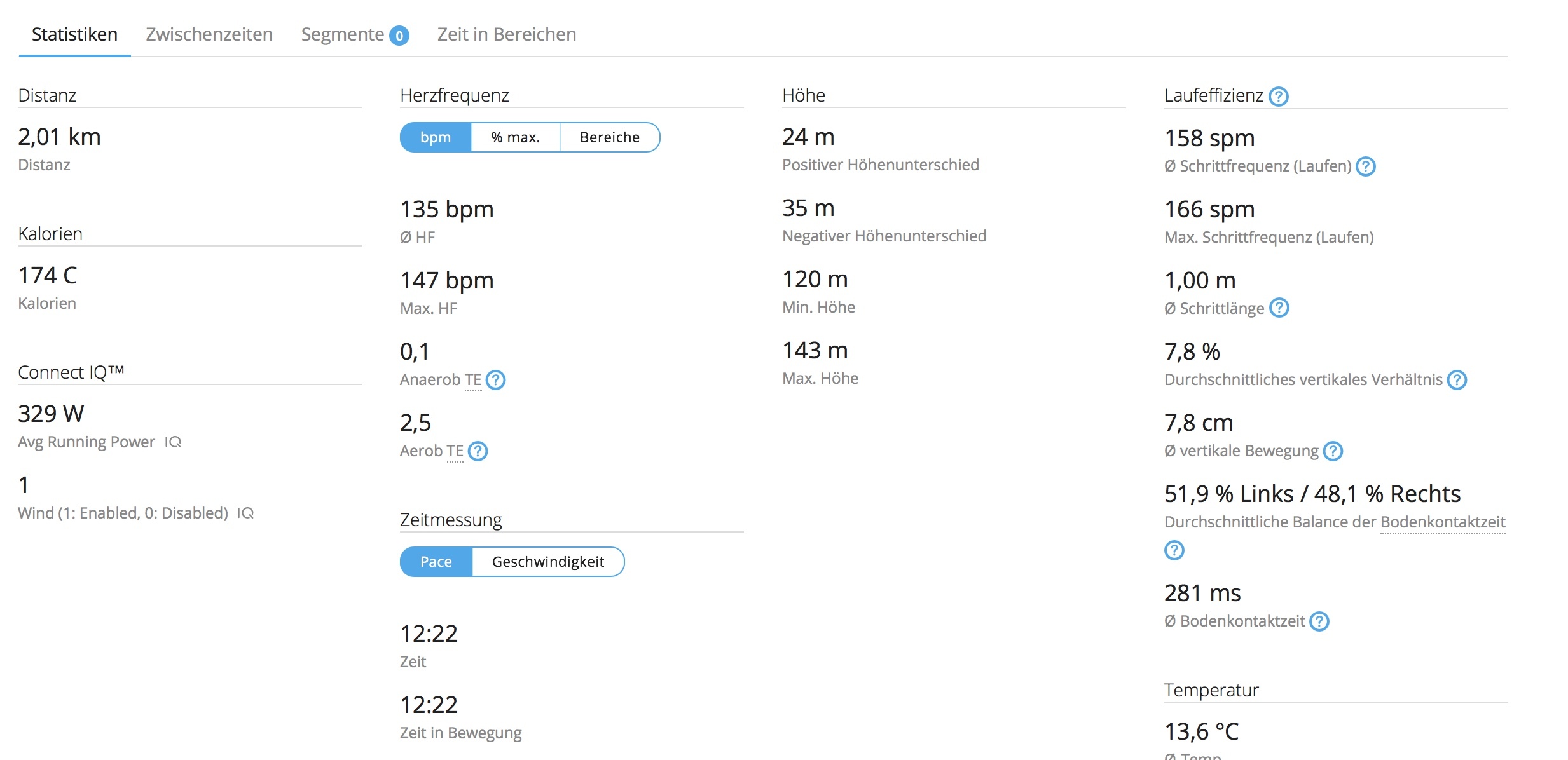

Can anyone advice me, why "Running Power" does not record data to show up in Garmin Connect?
Fenix 5 Sapphire
Beta software: 10.51.0.0
Thanks in advance! ciq.forums.garmin.com/.../1405879.png
Well, do you have one of the required sensors connected to your watch?
as of your screenshot it looks like you did not have running dynamics "recorded".. did you wear HRM-Tri upside down ?
your vertical Data and left right balance is not showing... you only have cadence and stride length, without the "other" data you don't get power.
for example a sceenshot from a short run I did recently
Have you set the data field property to 'Write power data to file'?
