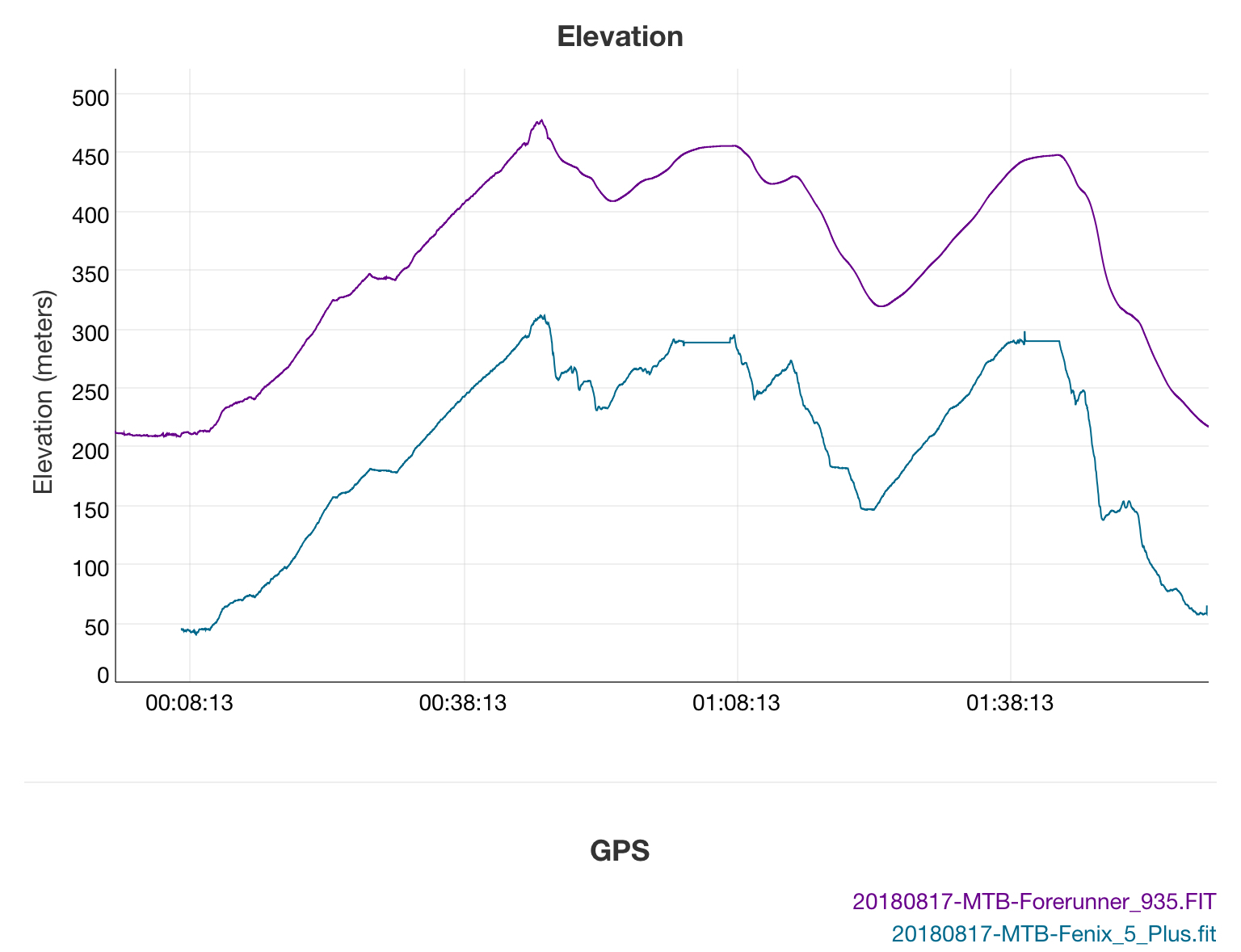

  • Just to add, the sort of thing you are looking for is comparing a plot like the one I attach below. If you ignore that my friend’s 935 wasn’t calibrated properly before starting (hence the general offset), you can clearly see the old bug in his elevation plot profile, where the ups and downs are smoothed out.ciq.forums.garmin.com/.../1403163.jpg
  • I had the obvious smoothing as well with other versions of the 5X firmware and this seems different. The thing that I keeps me second guessing the 5X is when I bought it in November (with firmware V6.00.00) I compared rides with my 910XT at the time and the elevation gain was ALMOST identical on many rides between the two. Since then nothing has changed on the 910XT (no more firmware updates) but the elevation performance from the 5X has been completely variable.
    Also when I ride the same course with my 910XT the elevation gains are always very similar to each other, even going back years ago. The elevation gain is very unpredictable with the 5X. Gains with V6.0.0 are different to V8.0.0 to the multiple V10's. Personally I am not too concerned with the actual elevation gain. What I would like it for it to be consistent so I can compare one ride to a different ride and actually know how much I climbed during my mountain bike rides. It is difficult to compare rides now because even riding the exact same course gives variable results with the 5X.
