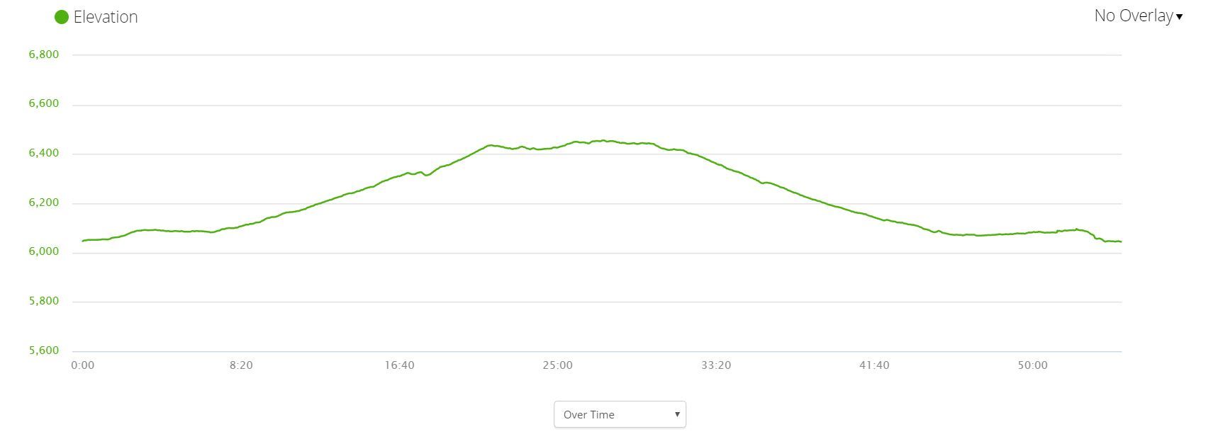

  • Start and stop on my trail run this morning was roughly 2-3 feet difference. We started at a friends driveway and ended at a slightly different spot up his driveway about an hour later. For me that accuracy is more than enough ciq.forums.garmin.com/.../1390064.jpg

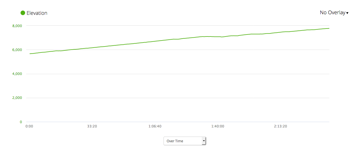

    Started at about 5600ft and ended this track at 8600 ft but the watch indicates about 7700ft.ciq.forums.garmin.com/.../1390078.png
