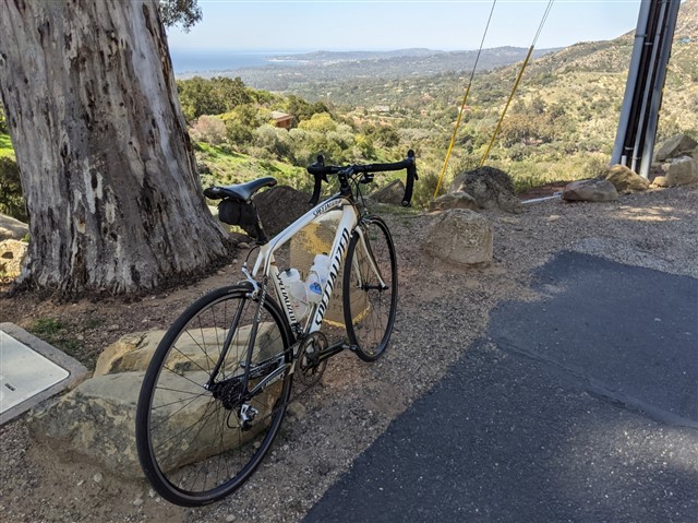

  • I bought the PowerPod Light, and the Garmin Speed Sensor 2, a couple of months ago since I stopped running, wanted to generate VO2max from my road bike. Been using it a fair amount and is working well and consistently. I charge it after I ride as it does lose a little charge sitting for a week or two. The biggest issue is finding the right spot to mount on your bars I routed my cables just perfect and the PowerPod must be clear of the cables, especially so they don't get snagged when turning the bars. It will mount either side. A minor issue. I think a good value. On a MTB the only consideration may be potentially hard drops or rough terrain. The only spike for a power reading I got was hitting a large drainage swale at speed, where power spiked to 1,000 as opposed to around 500. I have been riding some pretty chopped up pavement though and no other odd readings, so may have just been a freak incident. In any case, still a good value and I' give it a shot on my mtb too though just set up for my road bike.

  • There is the air tube in the front which monitors wind. That's the only thing they warn about. No need to center up. Mine is a couple of inches to the side about where my bar tape ends and could fit under my cables. The drop for the unit from the clamp is 1.5-2 inches.
