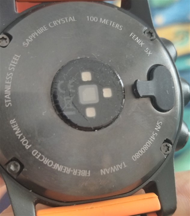

  • Found the charging / sync problem as it has plagued me as well as the watch ages on the fenix 5x plus model with gold contacts, the gold contacts on the watch side eventually wears down to the base metal and the action from sweat on those exposed pins causes a bit of corrosion which a light wipe with alchohol cannot clean properly, I found taking a wooden toothpick and waterless hand sanitiser seems to clean up the contacts and allow it to be charged. please refer to the image attached to see how the gold contacts eventually wears down to its base metalcorrosion on fenix 5x plus gold contacts
