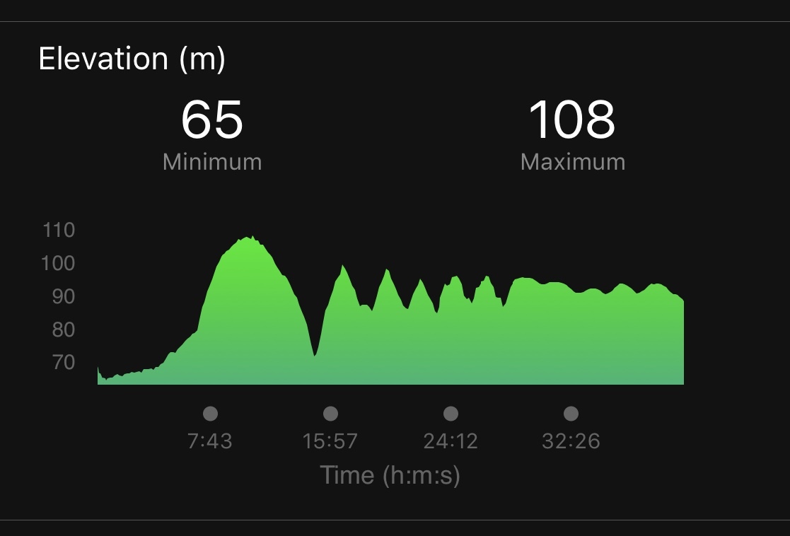

    Having the exact same elevation issiis on my Fenix 5S since the software upgrade. It seems during an activity once I originally topout on a climb the altitude calculation will freeze. It skips out on coubtcou the elevation gained on any shorter climbs and then will not work for minutes at a time on longer ones. Changes in elevation seem to trigger it freezing - as in when I start deacending. IveI notcied sometimes once I hit the lap reset it will randomly start working again. Not happy and I hope there is a fix soon.

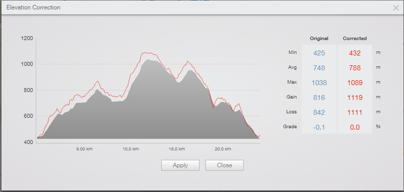

  • i have the same problem after updating from 8.10 (watch factory sw) to 9.20, road cycling with 2 device my edge 820 and fenix 5x start/stop same location with old sw i have 5-10 meter difference from both device but after update i around 1/2 of the elevation gain. If edge 820 have 144m elev gain fenix 5x have 70m. Friend fenix 3hr have 150m elevation gain on the same route, phone (strava, endumondo) app have around 140-150m elevation gain
