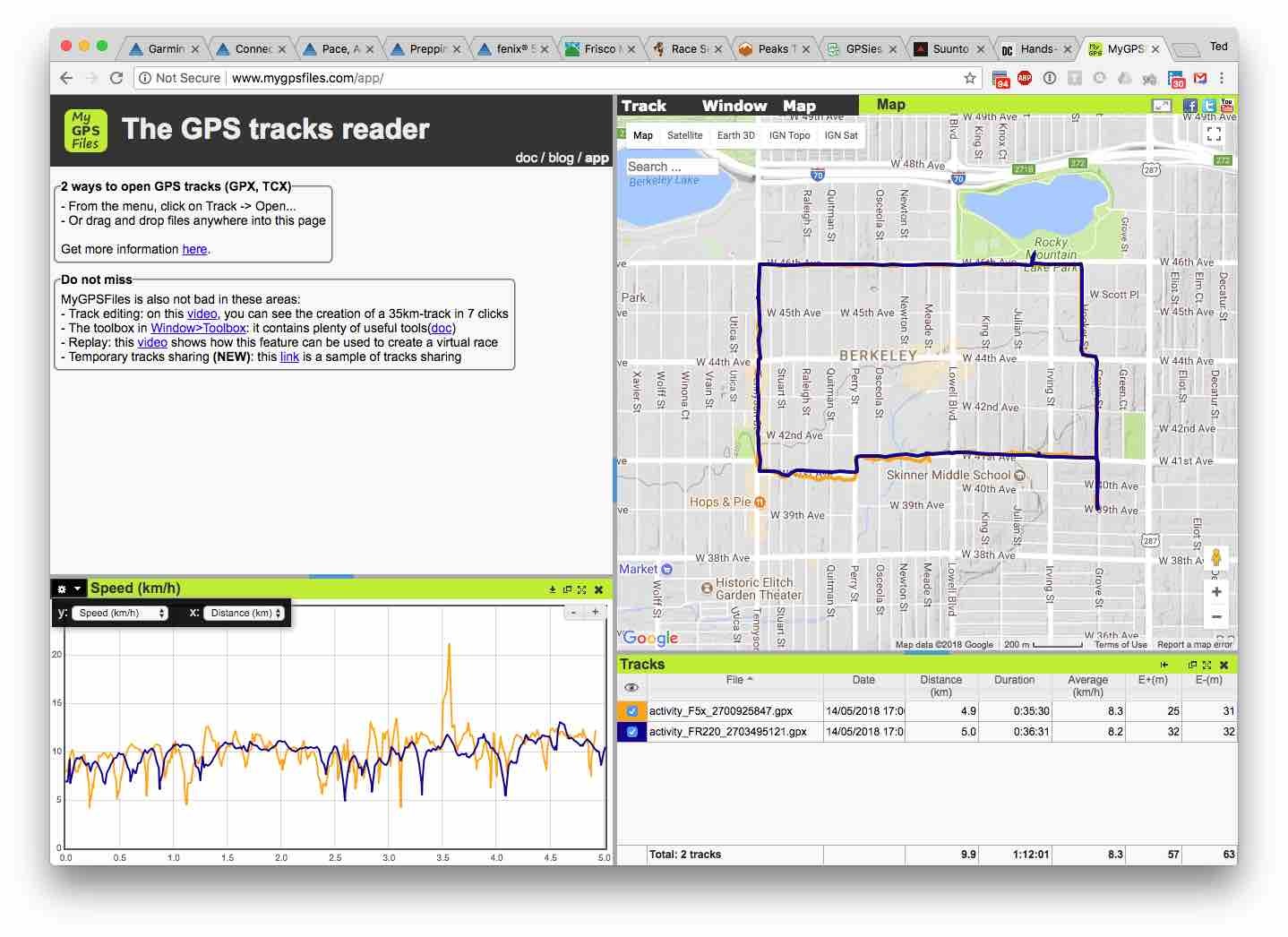

Here is a pic of one of the streets where my Pace goes very slow. There is also a pic of hte GPS track overlay.
Here is a link to the GPS file comparison.
http://www.mygpsfiles.com/app/#Ni9IxpUe ciq.forums.garmin.com/.../1363953.jpg ciq.forums.garmin.com/.../1363954.jpg ciq.forums.garmin.com/.../1363959.jpg

    Here are the GPSies GPX comparisons. I included the earlier data I posted as well as run from yesterday. As I noted early, you can really tell the difference on the graphs. The F5x still wonders a lot more then the FR220. The speeds also bounces around a lot more.
    http://www.mygpsfiles.com/app/#PdSv4frC
