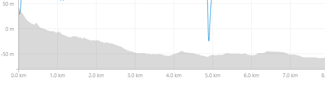

On almost every activity, my altitude starts 50m higher than it actually is, and then drops.
Is this normal?
ciq.forums.garmin.com/.../1362154.png

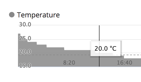

Could I persuade you to make a custom screen in an activity with the following four values:Then report the values you see immediately after going out and the values you see when the temperature has settled.
- Ambient pressure
- Barometric pressure
- Elevation
- Temperature
Jim, the temperature sensor should not change the altitude reading.
I am definitely not experiencing this and the temperature on pretty much every run has a similar trend as it's almost always colder outside than inside.

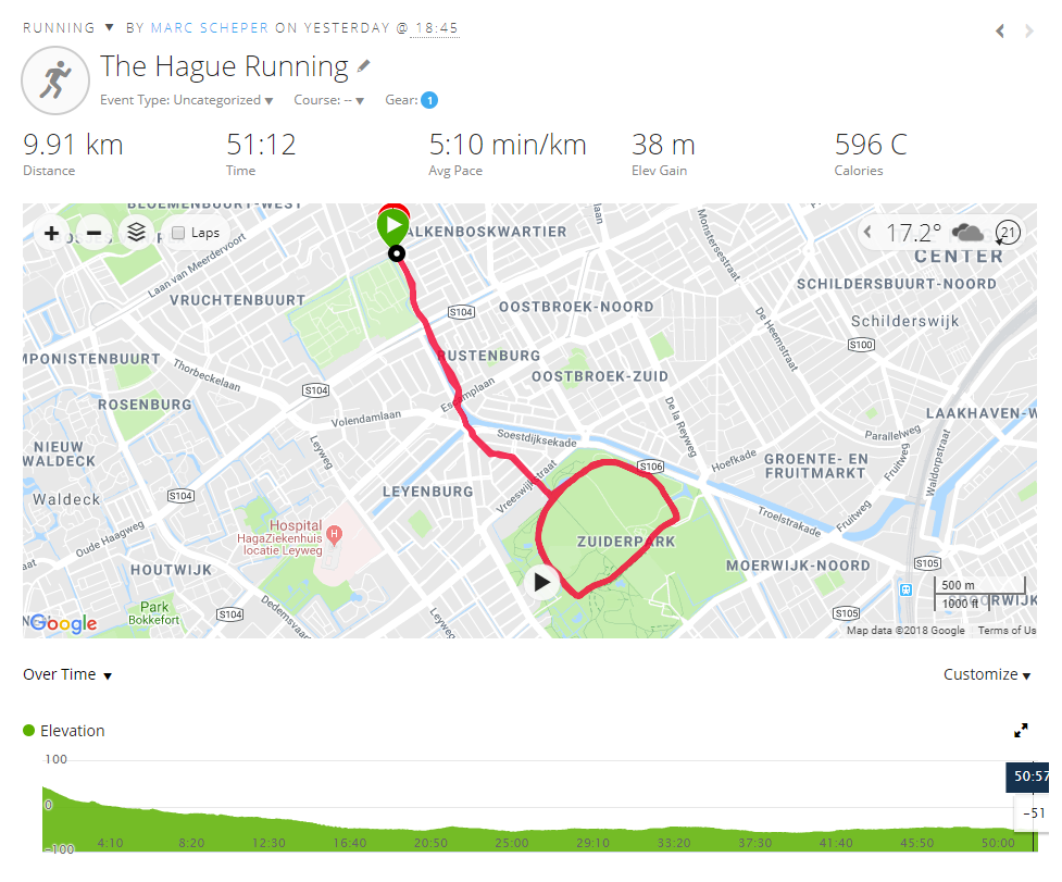

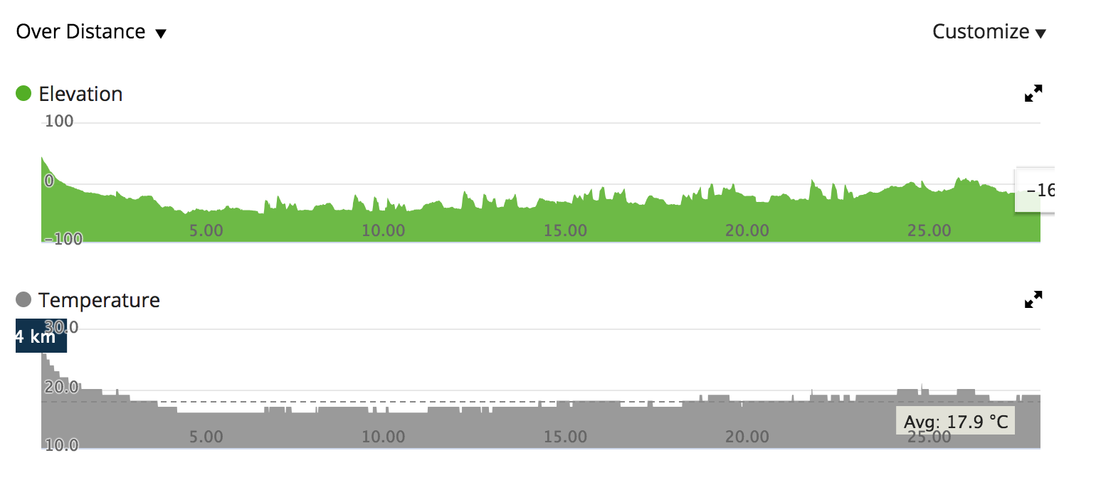

AllanOlesen67 barometric altimeter in the VA3 with firmware 5.0 has this behaviour (confirmed by numerous users):
placed at 23°C on the table for an hour it shows stable altitude of -3 m and ambient air pressure 1002 mb. This is at 10 m GPS altitude (3rd floor).
After 15-20 min on my wrist the readings are stable pressure is 1004 mb and altitude -16 m.
Going for a run: the altitude drops 50 m after 15-17 min and stays +/- 3 m for the rest of the flat run (1 hour).
https://connect.garmin.com/modern/activity/2777180652
With firmware 3.50 the behaviour was similar, just the period before stabilising readings has been even longer, 25-30 min and the initial fall in altitude with the rising temperature has been even higher:
https://connect.garmin.com/modern/activity/2649045663
Now, I put the watch into the fridge for 10 min. the pressure is 1002,2 mb, altitude is 4 m.
After 10 min back at the room temp. the readings are: temp 21 degrees C, pressure 1002,7 mb, altitude 1,5 m.
The Garmin SW site says: [h=4]Changes made from version 3.50 to 5.00:[/h]Well, not much has been fixed. Do you think it's an error in calculations or a fault in hardware design?
- Fixed issues with elevation recording
