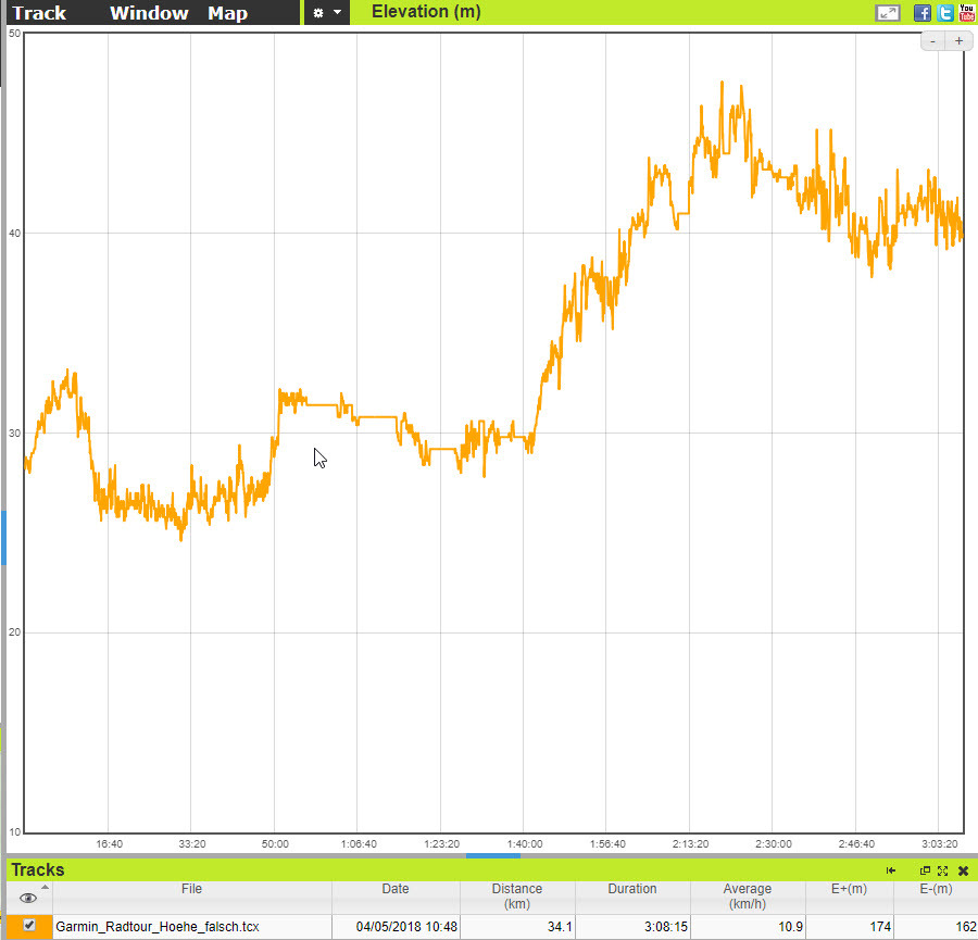

Hi, I am living in a totally flat area near the coast. My verified altitude at home is 28 meters.
When I start an activity, the watch uses GPS to read in the correct value: 28 meters.
I noticed several times that when I do a longer acivity, let's say a 3 hrs hike or bike tour, the watch then shows 42 meters when I am back at the exact same place where I started from, instead of the correct 28 meters.
Air pressure was rising in this case.
Now this isn't correct, as it should always show 28meters at the same position, as the watch during any activity always gets the altitude from GPS.
I have not found any possibility to fix this. I also contacted Garmin about it today and they offered no solution.
Did you notice something similar too?
ciq.forums.garmin.com/.../1344983.jpg
  • Your watch does not use the altitude from GPS during an activity. It only uses the altitude from the GPS once at the start of the activity to calibrate the barometric altimeter, and then the barometric altimeter is used during the activity.
    If the watch was using GPS altitude instead of the barometric altimeter during the activity, you would get a lot of false ascent meters because of noise on the GPS altitude. The barometric altimeter can drift a little during the activity when the surrounding air pressure changes, but it has almost no altitude noise.
    So you got 14 meters of false ascent because of air pressure drift, but if you had used GPS altitude for 3 hours, you would probably have had 10 times as many meters of false ascent.
