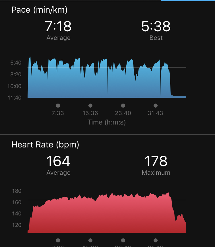

I wanted to give the heart rate based workout plans a try and have signed up for the half marathon training (level 2). The first workout consists of running at an easy pace (in heart rate zone 2) for 35 minutes. Turns out, I can't do it. I ended up running in Z4 for most of the time, although I was going much slower than I normally would and could have gone on forever. I started to question the accuracy of the wrist based heart rate monitoring, but I am also wondering if I run in a particularly inefficient way? Anyone experienced the same or can offer comparisons to the chest?
I have attached a screenshot of todays workout (trying to stay in Z2) and an average run (not running at a maximum pace, but at a pace that I can't do forever).

  • I don't run but mountain bike. I find the watch sometimes (seems more often than not with newer version 8.0) takes a while to pick up on the actual HR. Once its gets it, it seems pretty spot on. That said, its not as accurate as my belt. That tends to pick up the subtle increases/decreases in HR with far more accuracy.
  • Assuming that the HR readings are correct:
    The inability to run at a low heart rate can be a sign of a weak aerobic system, which apparently is quite common among runners. They have done a lot of training at high heart rates, which has developed their anaerobic system, but not so much developed their aerobic system.
    The cure is to run at low HR for some months, hopefully watching your speed at that heart rate slowly go up as you develop your aerobic system. After some months mix in some (not much) high HR training so you again train your anaerobic system. Then you will probably be able to run faster than before, because the improvement to your aerobic system will also help you at high intensities.
    Or at least that is the theory.
    (Using myself as an example: I am after a few months able to run at walking speed while keeping my HR in my intended range of 120-130 BPM. When I started, I could only run at 2/3 of walking speed.)
  • Thanks for your feedback. This has been very helpful and I realize that I should have read more about this before starting the training. I used the calculator for the heart rate zones suggested above and they are bit different than the ones calculated by my Fenix, but it doesn't make a huge difference. I guess the most important thing is to accept, that I will have to start really slow in the beginning. I researched a bit more about this training method and it seems like it is a common challenge that when you first start with these exercises, you need to start really slow.
  • They have done a lot of training at high heart rates, which has developed their anaerobic system
    Not so. it's only possible to run anaerobically (ie without oxygen) for a maximum of a couple of minutes. Anaerobic capacity is developed from interval sessions in Z4 and/or Z5.
    Two main reasons why inexperienced runners struggle to run at lower intensities:
    1) As already noted, the heart zones are not correct.
    2) Breaking habits. Without HR training, most people will run much harder than most training programs suggest, then find it hard to run to a specific intensity, particularly lower intensities.
    For running, in fact I'd suggest for any training following an HR based program, I'd strongly suggest using a strap as wrist HR is well known to be less than accurate or reliable.
