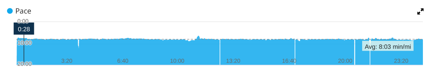

  • Just got my new Stryd Live in and went for a 3 mile run. Contrary to what is being said here I did get dropouts.
    there were 4 in total over the 3 miles and they look to be only a second or two long when you zoom in. I had the watch set to get pace and distance "always" from the footpod and both the instant pace and distance worked great. The miles chimed extremely close to where they do normally when I run this route with GPS and the instant pace was even steadier than it was with the Garmin footpod.
    I'll probably keep it as it seems like a great product but the connection stability isn't perfect. I'll see how it fares after a few more runs.ciq.forums.garmin.com/.../1331724.png
