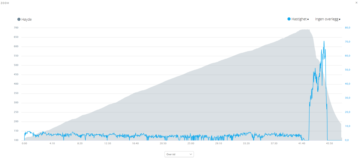

Hi. I am now on my second fenix 5x. Currently using fw. 8.00 have also tried fw. 8.54b.
I am experiencing very slow response of the altimeter.
it can use up to 4min to catch up. This was never a problem on fenix 1, 2, 3hr and epix.
this is also causing problem with decent values.
have attached a photo from one of my skimo sessions ciq.forums.garmin.com/.../1326485.png
