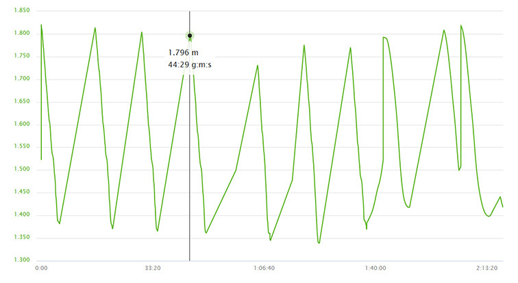

  • Unfortunately, I observed quite similar incorrect behavior during downhill skiing.
    After the downhill, the watch showed the descending height for a long time after the end of the real descent. The same goes when I use the ski lift up - I stand on the top of the hill but on the watch the height is constantly increasing. In both cases it takes from several to several dozen seconds, as if the altimeter display was working in slow motion :-). What's worse after each up-down series, altitude indications are getting farther away from the right ones.
    In my opinion, this is only an issue of the downhill application, because if you do an altimeter calibration using a GPS signal, it immediately shows the correct altitude. Unfortunately, this does not affect the height in the downhill application, which still shows the wrong height (even by 100m). My Fenix ??3 never had such problems.
    I do not know if this behavior is not affected by the patch which "Fixed an issue where the altitude on device wasn't accurate when using the Jumpmaster app."
    In the attachment the height graph - 10 times downhill, which starts and ends in the same place.ciq.forums.garmin.com/.../1319508.jpg
