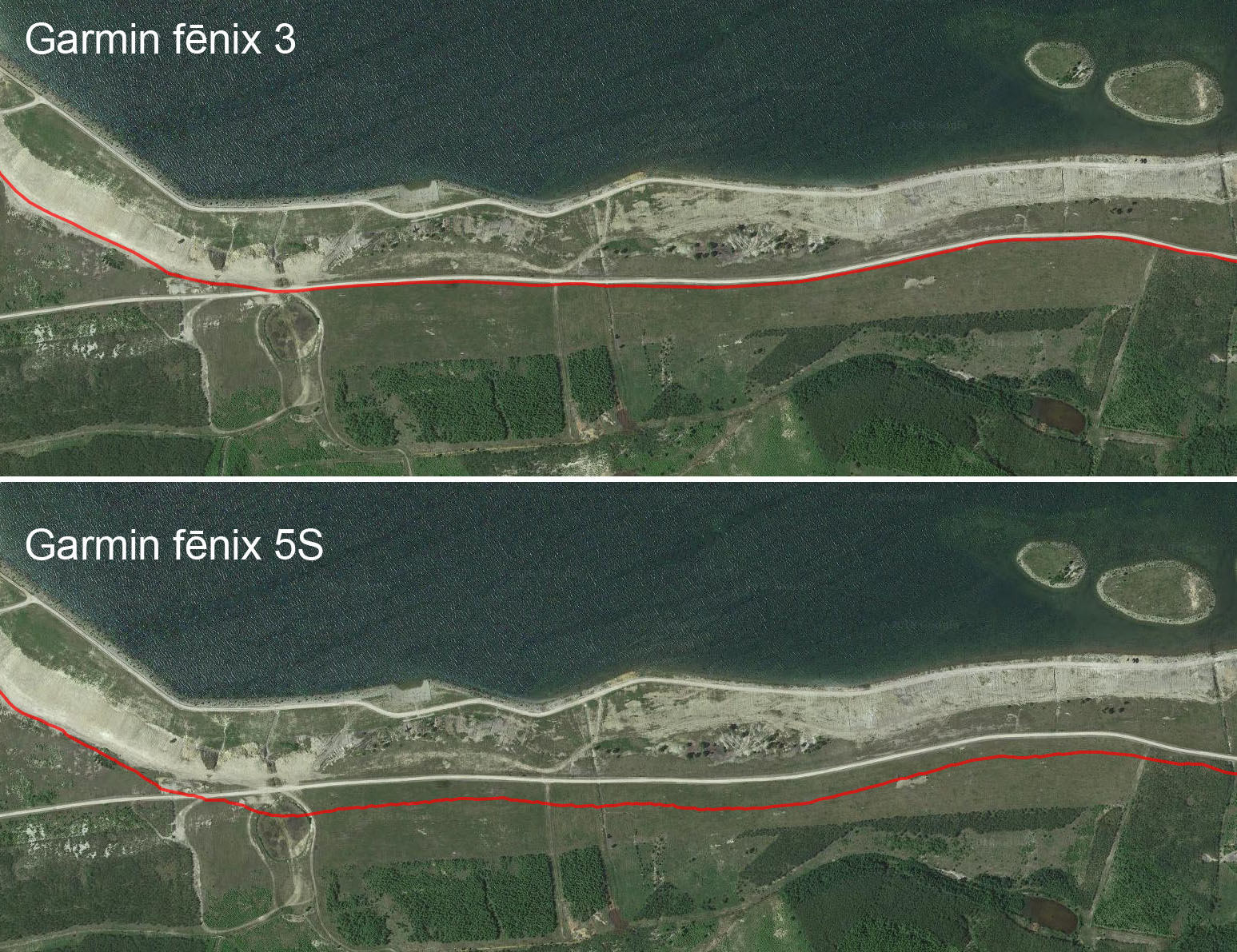

  • According to my experience (160 runs with 5s), the overall distance is usually OK (+/- 100m on 10k run). But if I look on the map, the tracking is allways horrible - 20m outside the track is normal. Also instant pace is not usable, if you want to run according to it.
    So I really don´t recommend this overpriced piece of scrap.
    (In attachment comparison with fénix 3 - no buildings, no trees, bright sky... and this is how it looks):

    Yeah. GPS is a mixed bag; as some of you will have seen from other posts of mine, I now use a footpod for distance, pace, instant pace. The GPS not only has real issues with overall distance in my case, it also indeed tracks outside the road/path, cuts corners massively, and gives me a seriously different result every time. Finally, the accuracy/precision changes every time the watch has to re-calibrate the GPS satellites.

    Second issue (independent of FW level) that I've reported many times now, is that when looking at the track on a map afterwards, it's as if it was run in less than sober condition: it cuts corners by as much as 10-20 m, places the track off the path or road, cuts across fields, etc etc.
