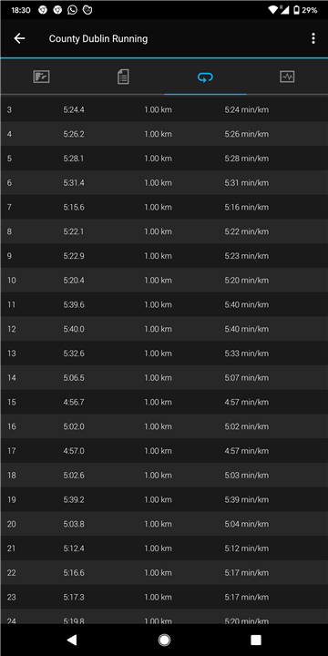

    Hi All,
    Have found my way here after completing the Redbull wings run. My Fenix5x is showing such bad timing data.
    We used the app which the race provides and basically you start 30mins ahead of a chase car which picks up speed until it catches you. Long story short, my mates watch (we ran side by side the entire way) showed smooth km splits increasing in pace the entire way, and so did the app. Both the app and his device (Suunto) showed roughly 31.1km while the Fenix 5x showed a total of 28.1km. it was showing over 5min/km pretty much the entire way and never registered a single km under 5mins while his device showed splits under 4:30 and one under 4min / km. I have attached an image of his splits Vs mine. We progressively picked up the pace through and his a Edgar pace was about 4:45/km whereas mine was about 5:20/km. The app also showed an average pace of 4:48/km for the 31.1km...
    Any suggestions? I don't have track roads set, the software is up to date, think it's just the Fenix 5x which is poor at tracking which is surprising considering it was a top of the range device?
    Thanks very much!
