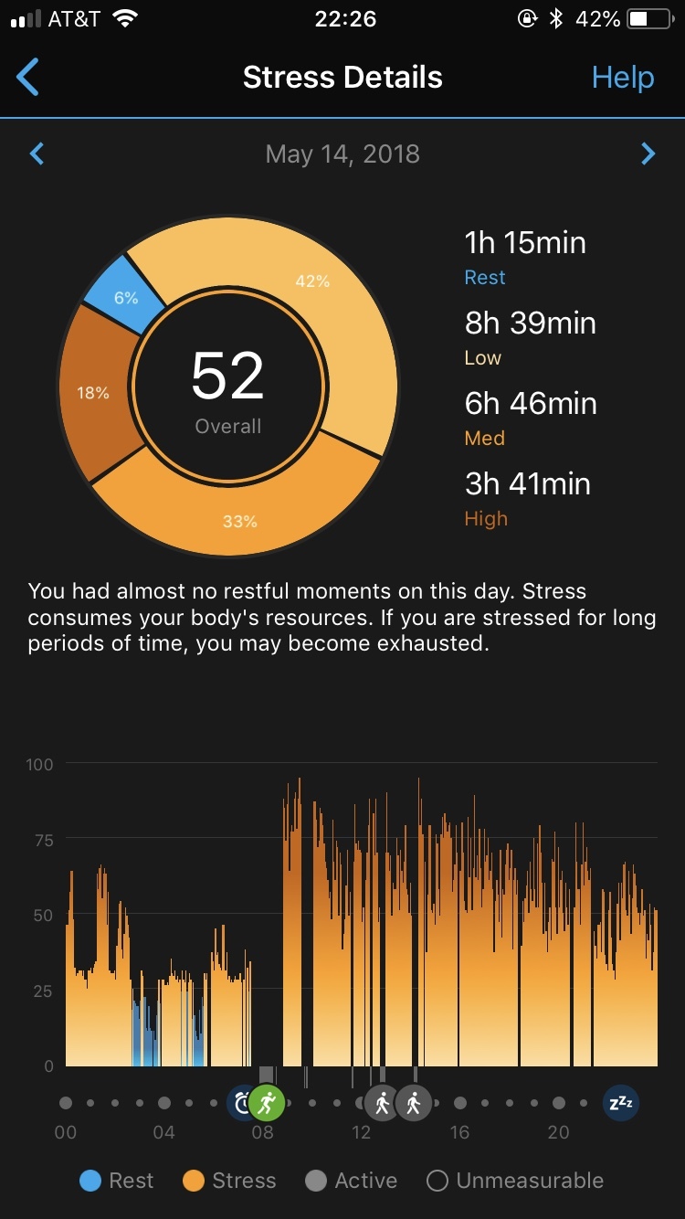

    So, I signed up for this forum explicitly to post about this. My stress widget has me in "high" stress about 25% of the time, medium stress about 25% of the time, low stress about 45% of the time, and rest about 5% of the time (only when I am asleep). It's constantly telling me that I am not resting enough, and that I'll become exhausted.
    What's funny is that I have a HeartMath Inner Balance HRV biofeedback device that I use explicitly for HRV training. I can be using the Inner Balance device, and see that I have very high HRV (it actually shows you the HRV graph, and it will show you the power spectrum, and the ratio between the high and low heart rate frequencies, so you can see the data for yourself, and see how it changes over time) -- so I can see that while I am in a state of very high heart rate variability with a HR fluctuating between 60 and 70 laying on my back, my Fenix 5 will say I'm in a state of high stress.
    This widget is junk! It's never worked for me, from day one.

    For reference, here's yesterday's full-day stress report. Note the near complete lack of rest, even during sleep. And I had three 10-minute long HRV biofeedback sessions in the afternoon and evening, when I was resting and had confirmed and measured high HRV measured with an earlobe heart rate monitor, plus an additional 15 minute meditation session. I don't know what the wrist-based Fenix 5 widget is actually measuring, but it is NOT heart rate variability, or at least it is not calibrated properly.ciq.forums.garmin.com/.../1348481.jpg

    For me, firmware had absolutely nothing to do with this. I got wonky readings when I bought the device in December, and I got wonky readings with each subsequent update. I even updated to the most recent beta after reading this forum (8.54) and I'm still getting the same wonky readings. I did try the hard reset trick, and I got normal readings for one day, like others suggested, but after that one day, it went back to high stress all the time, with basically no rest.
    Is it maybe a skin type issue? Does the photo monitor have trouble measuring the R-R interval with certain skin types?
