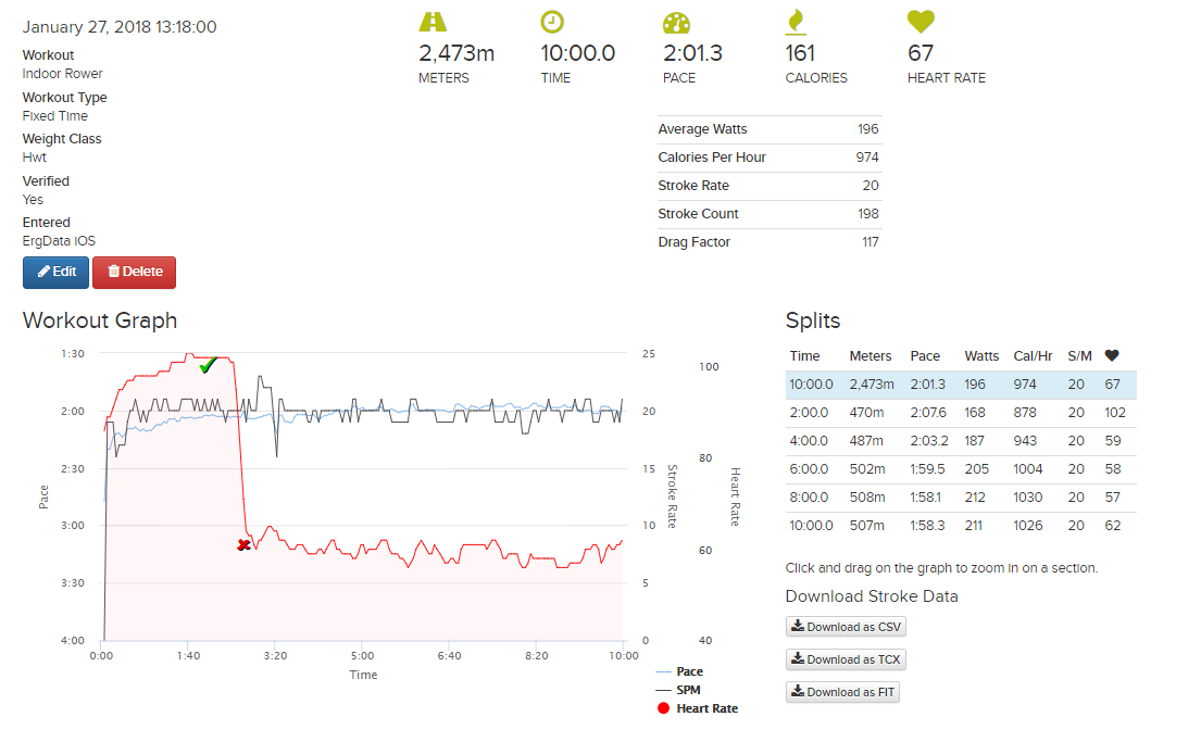

  • I'm facing a similar issue and I'm most confident that this happend over one of the last updates. First I thought it might be me and it is all in my head. But a few days ago I was working out on my rower and looked at my heartrate that suddenly collapsed mid workout. So there is definitively something wrong with the wrist hrm of the Fenix 5x. But as I said, I'm most confident that this happend in one of the last firmware upgrades. EDIT: Right now I use my Garmin swim HRM for all workout activity. But it would be nice to get the wrist HRM working again.ciq.forums.garmin.com/.../1303779.png
  • How do you know whether it was correct before the update or after
    Would be useful to do a comparison using a chest strap so that you have an accurate baseline to compare against
    Do you know what your maximum heart rate is as 177 seems quite high to hit in a non interval session
