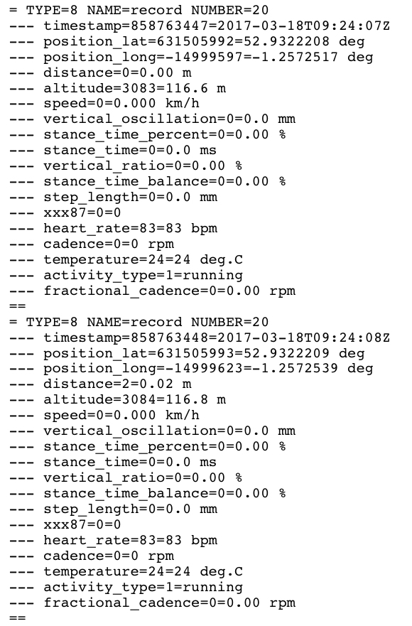

  • Hmm. That’s not normal; especially as you say it’s showing the RD pod in Garmin Connect. I have heard of people missing CIQ data graphs (from Stryd or RunScribe) as their Garmin Connect accounts are not recognising their watches properly, but I’ve never heard of Garmin’s own RD data not making it into the graphs on Garmin Connect. Any chance you could post a link to one of your Garmin Conn3ct run activities with this issue (only if you’re comfortable doing so, and have set up privacy zones in Garmin Connect before making public so we can see it).
    The other thing to try yourself is upload one of the fit files direct from your watch (go to the GARMIN/ACTIVITIES folder) to https://fit2tcx.runalyze.com/temp/ where you can actually see the info recorded every second in the fit file to see if the RD Data is recorded (see an example screen shot below)ciq.forums.garmin.com/.../1289809.jpg

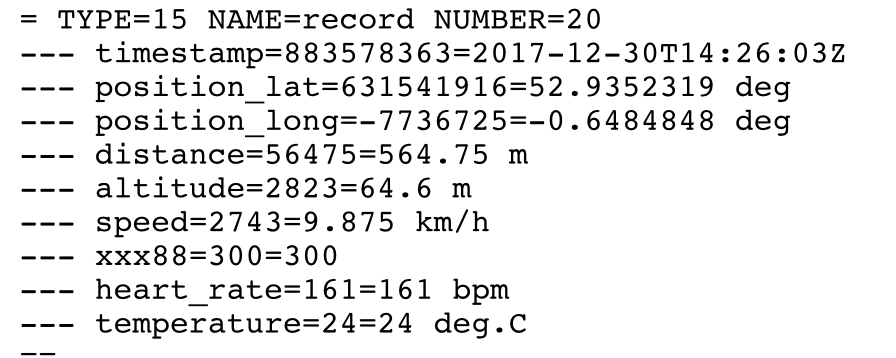

    Okay - my Pod was definitely connected during the run because it warned me to remove it after the run and it showed the running (pod) icon during the run. I have attached the FIT dile and a screen shot :) Loving the help - thank you :D
  • I’ve just run your fit file through the website and it seems the RD data is not being written to the fit file. Maybe there’s actually something up with your RD Pod; so maybe time to contact Garmin support or just return it to the shop for a replacement.
    Also, Happy New Year!ciq.forums.garmin.com/.../1289929.jpg
