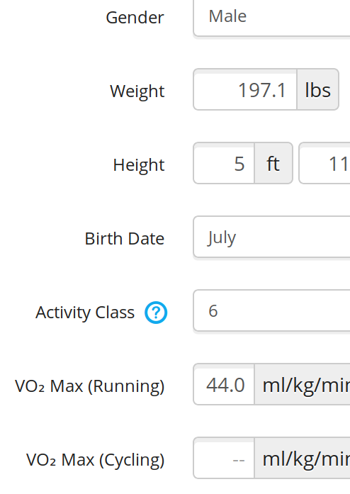

  • A few things to check:
    * that your body weight metrics and units are correct (eg. that you haven't accidentally entered 195 kilograms).
    * what are your maximum and resting heart rates, and how did you measure these? And what heart rate are you normally when walking or running on the treadmill?

  • I had put in a resting heart rate of 70bpm, as my fitbits and and apple watches usually show 68-70. Garmin says 75 after wearing it a week so I'll raise it to that in the HRR settings and see if it makes any difference. It filled in a max heart rate of 181 on its own, which I assume it calculated based on an age formula. Walking on the treadmill at an average 20min / mile it recorded my average heart rate as 115bpm.
    I hope the answer lies in a bad data field some where. I've thought it over and I think I'll return it before buying a footpod.
    I took off the watch to sleep, but have 59 calories burned for my 378 steps.
    ciq.forums.garmin.com/.../1289597.png
  • Something I just found: When I go into Settings / User Profile / Heart Rate on the watch it says for Resting Heart Rate "--". I changed it to Use Average which was 75.
