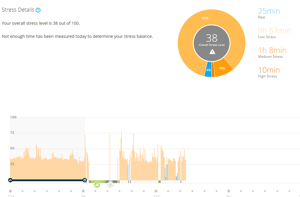

  • I'm getting a little tired of this myself. I have chronic "high stress" especially when I am asleep, including deep sleep. I don't know how much more relaxed I could be. The app berates me for inciting my impending exhaustion. The ONLY blue bars I get, sometimes, are when I have a Diet Coke and read the news once a day, and when I push the cart around the grocery store. Day in, day out, my % high stress is many times over my % rest. I have literally had a 12-lead ECG and 24 hour Holter monitor exam because this was so unnerving, given that low HRV (= Garmin high stress) is tied to heart malfunctions. Those tests along with the blood labs were normal.
    When I initially got the 5S, it had a lot of drop-outs during sleep, but a lot more reasonable levels, including some rest (blue) during sleep, and rest at times in the day that I felt were restful. About the time of the firmware update, I also had the flu, so I attributed the horrific overnight levels and elevated day levels to that. However, I've long since recovered and the watch has not.
    I sure am hoping this is a bug and they will soon fix it. I have reported it, got a "thanks for letting us know" message, and then radio silence since.
    I'm just glad to see it is not just me.
  • Former Member
    0 Former Member over 7 years ago
    Interesting safeandsilent. My Stress values did go back to bad when I had a virus, and I sort of hoped that they would go back to normal levels, indicating overnight rest when I got better. It is probably a little too early to say that it is broken, but I am only seeing around 25 minutes rest a day now, which again does not appear right. The nexy step for me is to hard reset in a few days time if it does not settle down and see how long it lasts again. It could be recording correct data, but again from how I feel, it does not appear representative.
