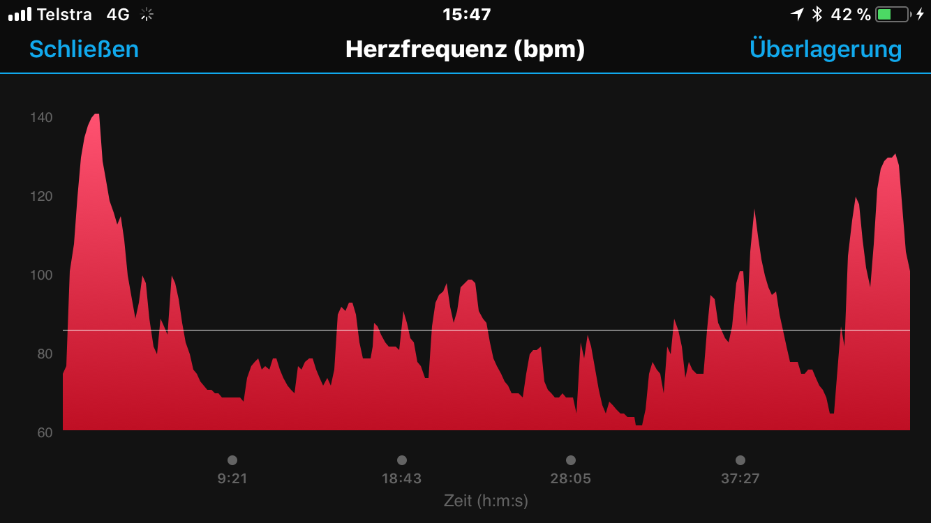

My problem with Fenix 5 and firmware V6.71: HR works only the first 6 min and after 18 min correctly. Sports equipment: Stepper. See HR-photo. Changing position of Fenix is no solution. ciq.forums.garmin.com/.../1260337.png

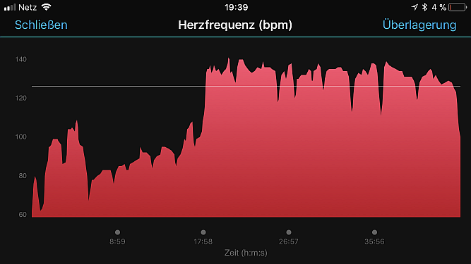

    Hi,
    I have the same problem that the HR is dropping after the first couple of minutes and is accurate for running only after 20min. For Weight Lifting it is even worth. This wrist HR is not close to be realistic. In my Gym exercise I did a warm up run and cool down run, but my HR during the weight lifting is shocking. Sometimes around 60 BPM where it should be around 150-160 BPM. I am using a EMS suite during this training where I can't use a chest HR belt.
    During the day without an activity the HR rate looks reasonable to me. Any suggestions???

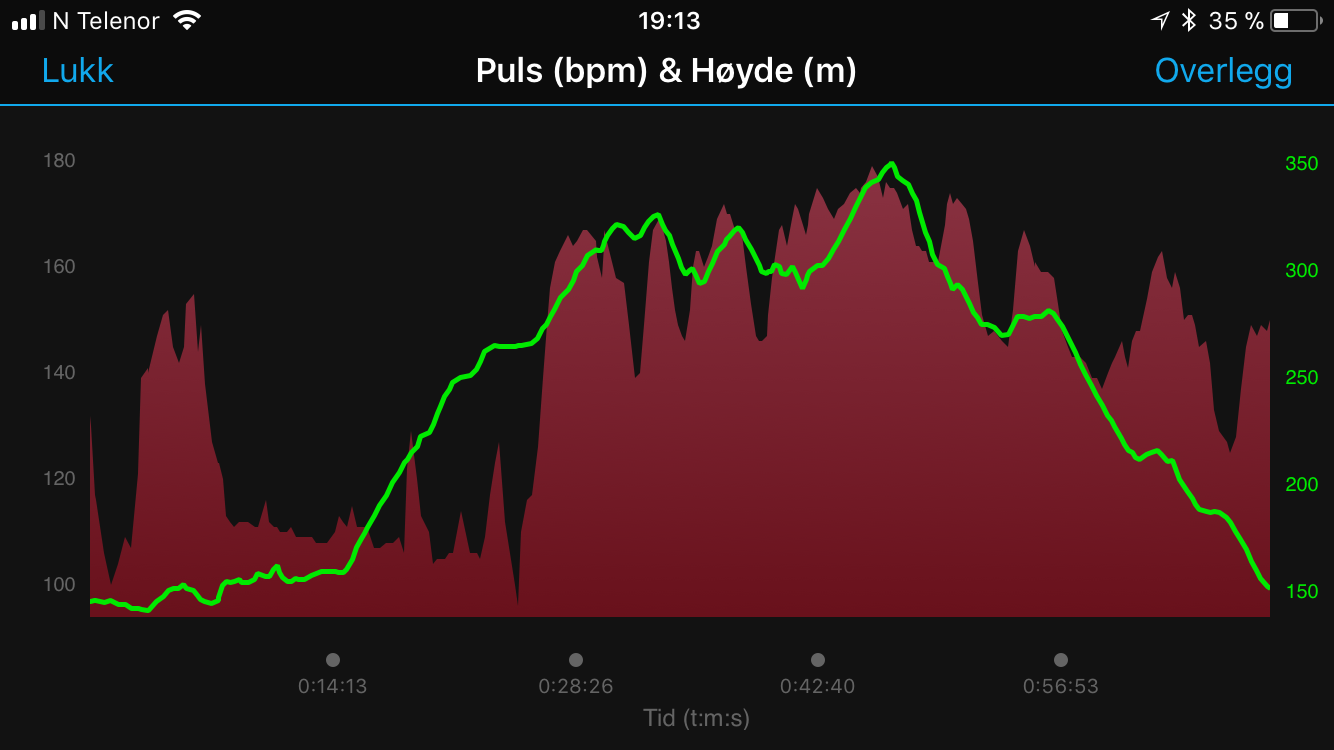

    I have the same problem. Firmware 6.0. Don't happen all the times but it is normally on the same time when it happens.... ciq.forums.garmin.com/.../1260700.png
