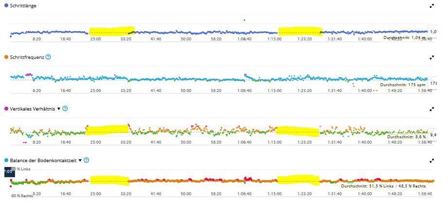

    Same for me this morning. Updated yesterday to the latest beta and today morning on a 22km run I had 4 or 5 re-connects for all the NAT+ based sensors. (HRMrun2, Tempe, Stryd).
    The graphics also show a different thing: There are some longer outages of data missing. Stryd-Data is fully present.
    Will report this to the Beta-Team as well
    I tried to turn off then on the watch but I had again some random sensor disconnect/re-connection that result in chunk of missed data in the various graphs on GC. I sent a possible bug report to the beta-team.
