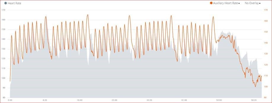

  • Here's a graph comparing how the OHRM and chest strap HRM tracks during interval training. The orange line being the chest strap data and the grey being the OHR data. As you can see the OHR completely misses sudden increases in HR most of the time. I believe this is as a result of filtering that is in place to try eliminate false readings. My recomendation is to use a chest strap HRM for interval training.ciq.forums.garmin.com/.../1243831.jpg
