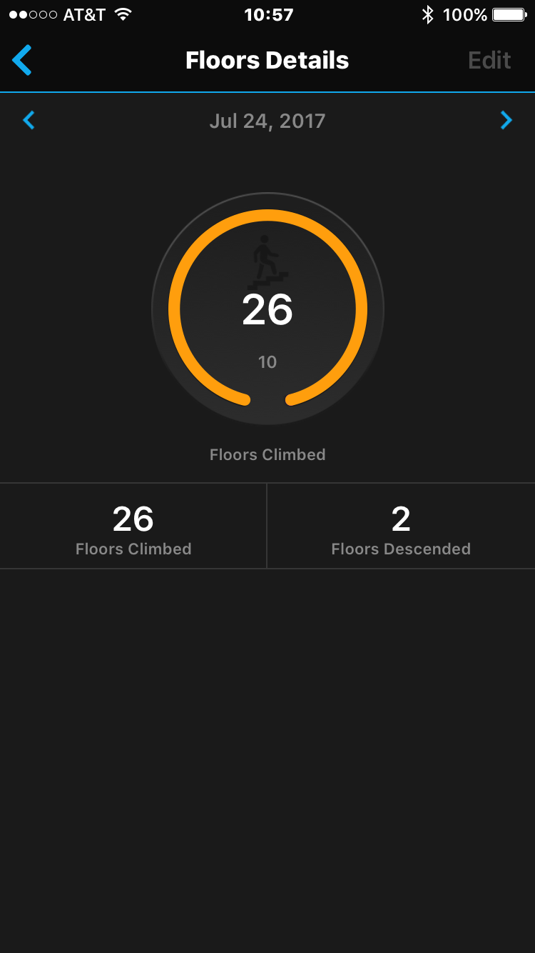

Hey there everyone. Former Fenix 3 owner who counts himself lucky for dodging all the reported problems the 3HR had with its altimeter/barometer...... I've had a Fenix 5 Sapphire on ver 4.1 for the past two months or so with no issues, until around 2 weeks ago. I was walking around my house in the morning (having only been out of bed for about an hour) when I received a GOAL alert for completing my stairs goal (set at default of 10 flights)...... well this is weird as I don't have stairs in my house and I hadn't left the house at all for the hour I'd been awake. So...... I went to my ABC widget and noted that my altitude was all over the place. If you check out the pictures you'll see the watch suddenly decided I had climbed to 7,224 feet from my normal level of around 200-200 feet.....and then quickly dropped down to -1,786 feet. You'll note that after that the altimeter reads 203 feet and remained steady for the next 3 hours or so. The 203 feet was based on a manual calibration after I noted the huge variations. The shot of Garmin Connect for stair shows that the watch thought I climbed 26 flights and descended 2 during that weird episode. I can attest to the fact that there were no pressure gradient changes/systems in the area. Stable pressure was present.

So, with all that, if you've read this far good on you!!!!! Any thoughts on this? Thanks! ciq.forums.garmin.com/.../1239045.png ciq.forums.garmin.com/.../1239046.jpg ciq.forums.garmin.com/.../1239047.jpg
