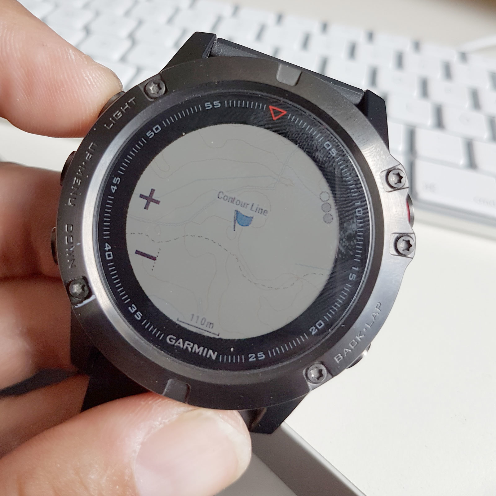

Is there any way to increase the thickness of the lines of the maps? In my case, I purchased the TOPO Sweden Pro map from Garmin (appr. 170 ?) ? but it is barely usable when out and about. I attach a screenshot, which I slightly adjusted in PhotoShop in order to be truer to what you actually can see on the watch. The one thing that is clearly visible in the screenshot is the dashed line (a footpath). But just under the C of "Contour Line" a much larger, paved road passes, which is barely visible on the map. When out and about and subject to reflections, it is basically impossible to separate contour lines from paths, area outlines etc.
So. Are all of the strokes defined within the map itself ? or are there any parameters that could be tweaked on the watch in order to force the unit to draw certain lines bolder or in more distinguishable colours? ciq.forums.garmin.com/.../1237512.jpg

    BTW: here is, how it looks when not using a screenshot but taking a photo. Even worse than what I accomplished in PhotoShop...
    ciq.forums.garmin.com/.../1237531.jpg

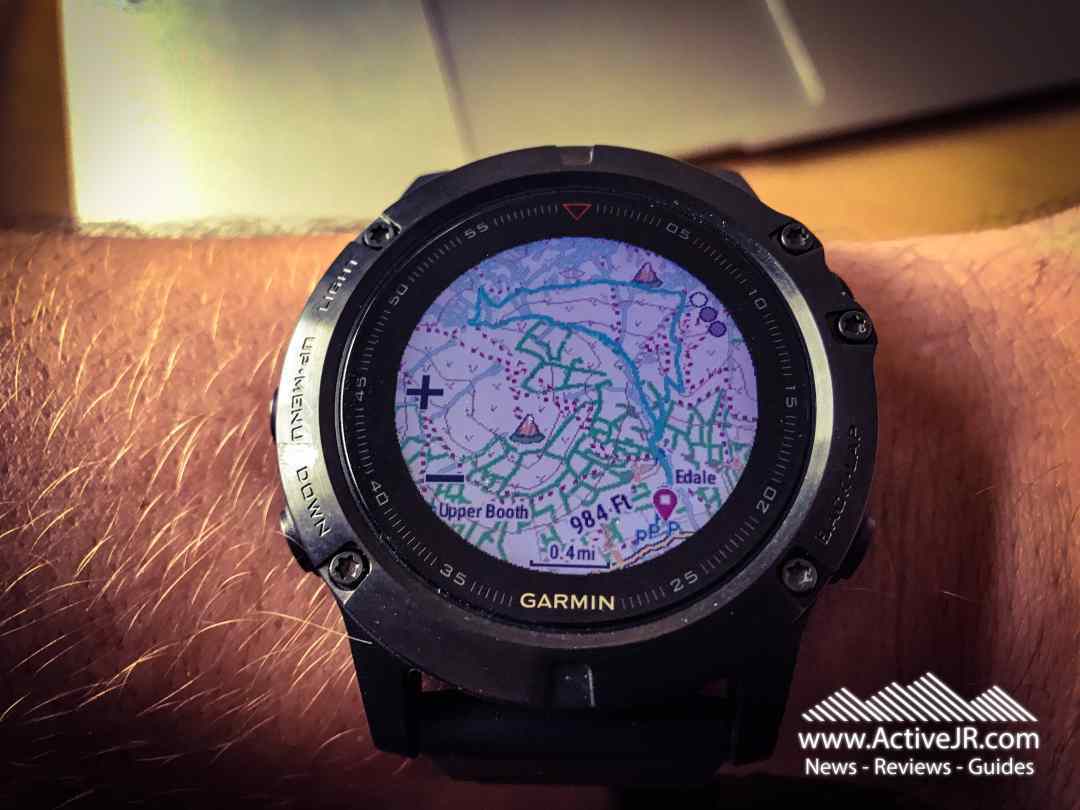

    Being honest, the maps that Garmin are ok for most people but people like hikers etc etc will struggle with the contours and to get details. I have a Video on my YouTube channel that shows you how to install third maps that improve things. You will see from the image below that the lines, paths and contours are more visible.
    If you want to use the video, its here
    https://youtu.be/0V_04TnzXaU
    Full disclaimer its my videociq.forums.garmin.com/.../1237582.jpg

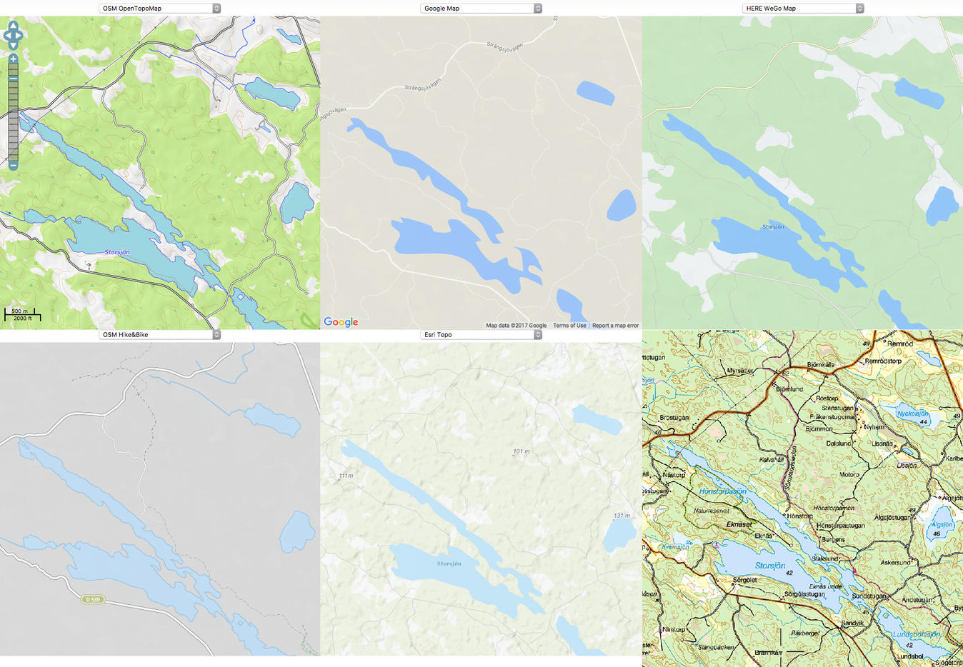

    I really do appreciate all your helpful tips about osm-based maps, but they simply are not usable in my area. Up here, it is too sparsely populated for community-created maps to work reliably. Even Google et.al. don't bother for roads that cannot (at least theoretically) used by vehicle.
    I attached a comparison of an area not too far from where I live. None of the different online mapping sources come even close to reality. In the bottom right corner, I pasted in the material from the "official" map, which is the same source that is used in Garmin's Topo Pro maps.
    So, at least in the area where I live, the official Maps are (afaik) the only ones that can be reliably used for hiking.ciq.forums.garmin.com/.../1238113.jpg
