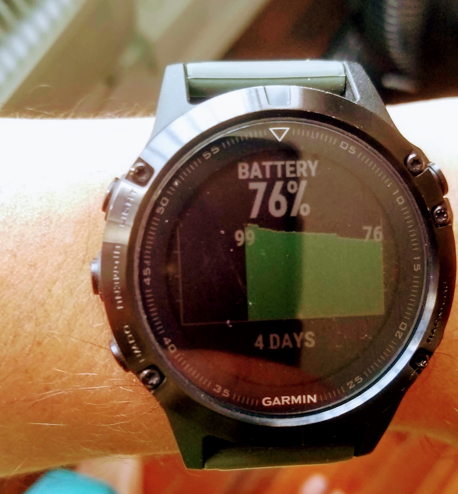

    Hi Everybody! This is my first post here.
    I’ve owned a Fenix 5 Sapphire Edition since last December and, until firmware version 12.30, I used to recharge it every 12 to 14 days, depending on the number of activities. After updating to 12.40, I noticed that its battery was lasting only 5 or 6 days and it didn’t improve after version 12.50.
    I’ve been searching for a fix and I think I finally found. I downgraded the firmware to version 12.00 (available on http://gawisp.com/perry/fenix_D2_tactix/fenix5_1221Beta.zip), turned off Auto Update (this is very important so the watch can’t automatically update to a higher version again) and then I recorded the following measurements, all of them made using Battery Gauge widget (https://apps.garmin.com/en-US/apps/4370b941-4874-41f4-82d1-d10924eb4bfa):
    - From 03APR 08:27 am to 05APR 06:12 am => -10.0%
    Average = 10.0% [FONT=Liberation Serif, serif]÷[/FONT] 45.75h = 0.219% per hour
    - Activity: 30 minutes running = - 3.22%
    - From 05APR 07:30 am to 06APR 07:28 am => -4.7%
    Average = 4.7% [FONT=Liberation Serif, serif]÷[/FONT] 23.97h = 0.196% per hour
    Impressively good, don’t you think? ;)
    Now, my watch’s looks like the following:
    Watch Face: SC8 (https://apps.garmin.com/en-US/apps/abc0fde3-23d3-4c8d-92ec-a2fd14aeab2f)
    Firmware version 12. 00
    GPS 2.50
    WiFi 2.40
    CIQ 3.0.1
    Sensor 6.50
    WHR 20.03.31
    I hope this helps you all.
    Best regards.

  • Unfortunatelly the problem remains. Only with v 12.40 I had seen a small improvement and the watch was close to the manufacturer's standards. From then on (V12.5-13) it returned to the poor state described in this thread. Again, it returned to consumption -0.8 & -0.9% & 1.1% per hour.
  • Former Member
    0 Former Member over 6 years ago
    Same here, with 12.85... After 3 days, power consumtion is back to 0.8/0.9% per hour.
