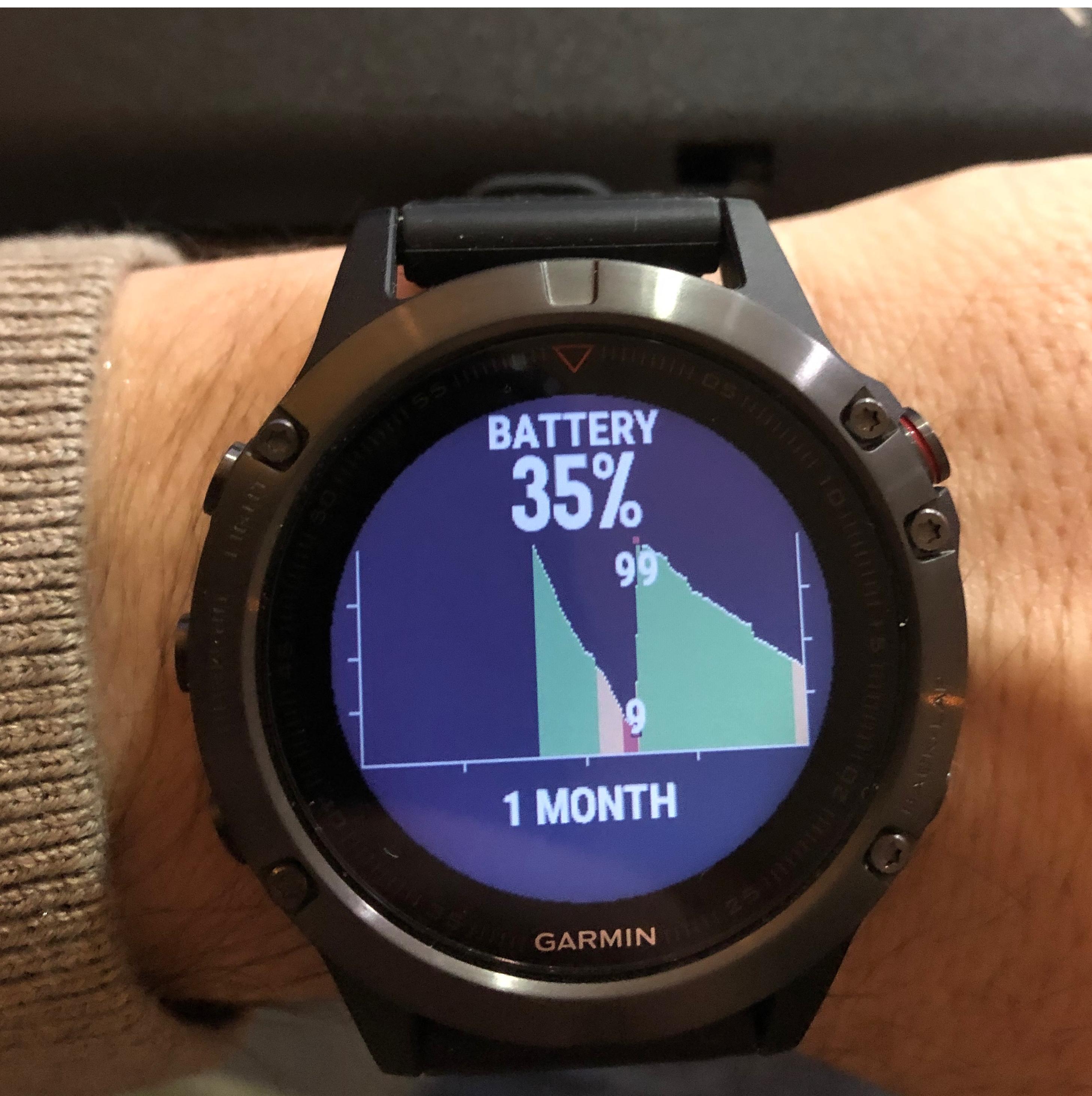

  • hmmm ... everything seemed fine for me on everything up to 12.00 ... upgraded to 12.30 recently and battery gauge is now reporting a much higher per hour (as in over 1%-2%) ... can you see when it happened ? :p
    ciq.forums.garmin.com/.../1451367.jpg
