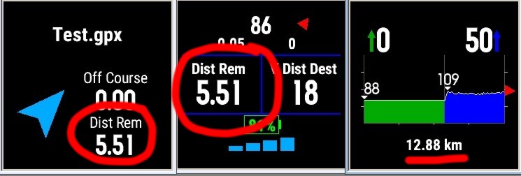

    Not. Not at me (Fenix 5X - FW 4.10) :-)
    OK - At the navigation: "Use of Map" - yes (bug).
    At the navigation "Follow course" distance = distance course.
    The starting position is ca 5.5 km (according to the course) and 3.3 km of the straight line:
    this way he is showing my watch (5.5 not 3.3 km):

    Yes, only a bug at navigation on a routeable map.
    I have missed somehow that you are talking about "follow course"...
