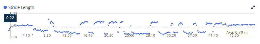

    I think I might be suffering from this issue with my new Fenix 5S. For example, see the attached image.
    Jogging with a Garmin foot pod on the treadmill; completely steady state, I saw the pace all over the place according to the watch during the workout, and afterwards I can see that the stride length basically seems to be the problem.
    It seems to be alternating between two completely different values, so for the steady cadence the implied pace is completely different. Is this possibly due to the foot pod connectivity fading in and out? I have the RD pod too and that seems to be locked in OK.
    ciq.forums.garmin.com/.../1304613.png
