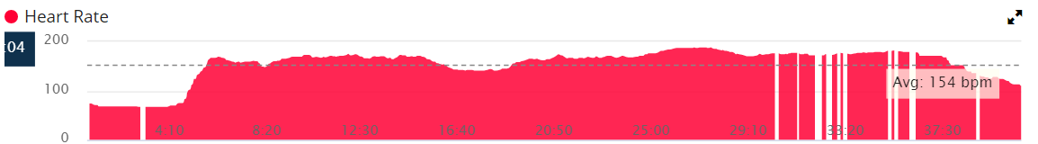

    Here is what my fenix 5 + HRM RUN looks like with 30 minutes of running, also notice the way off low reading at the start, and then towards the end when i just got fed up becuase the HR just started dropping rapidly despite increasing pace and effort.
    ciq.forums.garmin.com/.../1228075.png

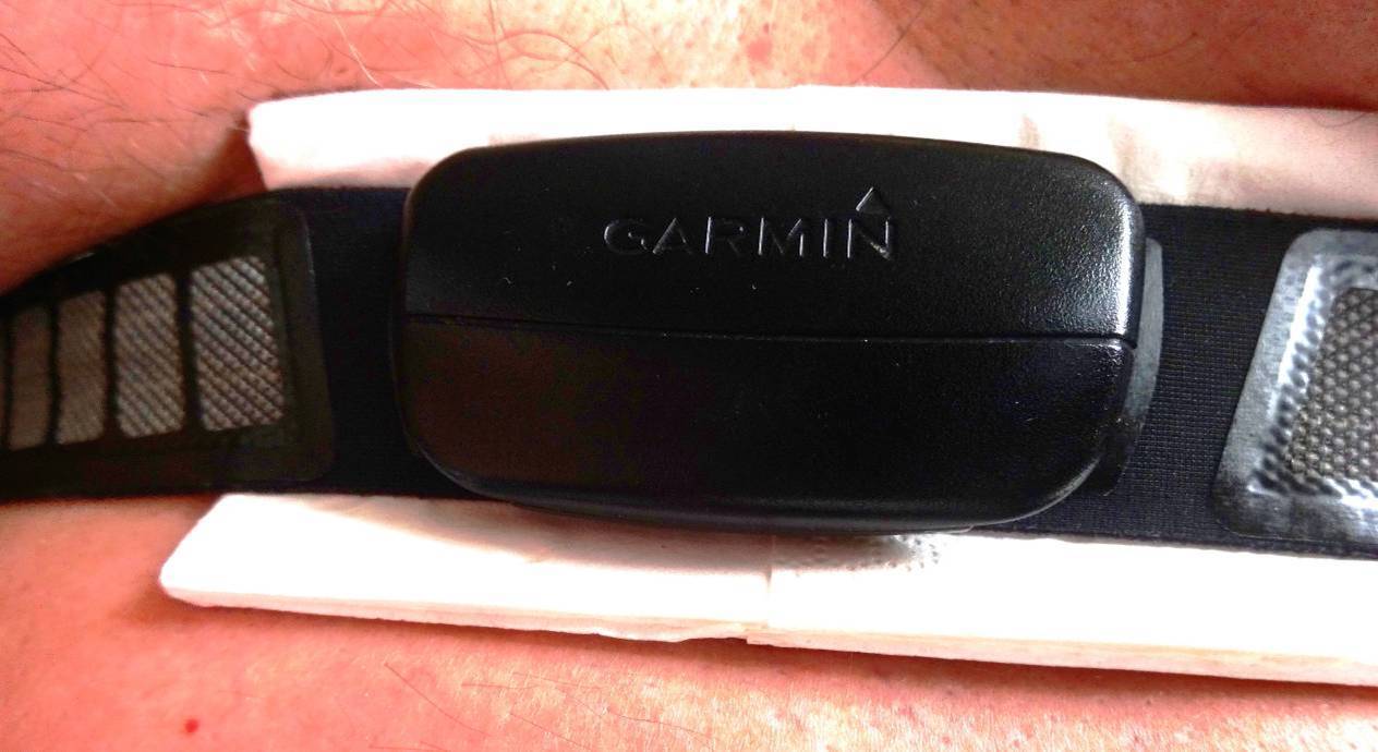

    N O - M O R E - D R O P O U T S - a simple remedy
    Hi, everybody who experiences HRM dropouts. I do not think that the dropouts have something to do with the ANT+ connectivity. The problem is much simpler as I found from the evaluation of the HRM records. The problem is due to fact that Garmin apparently did not consider the perspiration when designing the HRM belt. I had constantly dropouts after some time from the start. Then it came to my mind that it might be due to perspiration.
    I recommend you to use a very simple remedy - put two paper tissues under the belt where the HRM sensor is clipped on.
    You will never see the dropouts any more.ciq.forums.garmin.com/.../1228376.jpg

    haha can?t tell if you?re serious. So should I wrap my power meter and stryd in tissues?

    But if your point is true why isn't the problem visible on Fenix 5X, only on 5?
    as seen in my post, same HRM-TRI was used with both watches, and ONLY dropouts on Fenix 5.

    The problem IS in bad Fenix 5 ANT+ receiption.
    I tried 3 different watches (Fenix 5, FR935 and FR910XT) with 3 different Garmin HRM belts at the same time. Only Fenix 5 had dropouts with all 3 HRM belts. FR935 and FR910XT didn't have dropouts with any belt.
    Furthermore, when I tried Fenix 5 with HRM-TRI, it showed dropout, but later when I downloaded stored HR data from the HRM-TRI to watch it didn't show dropouts anymore - it means that HRM-TRI recorded HR data correctly (and stored them in its memory), but Fenix 5 was not able to receive all transmitted data.
    The ANT+ receiving issue is easily reproducible:
    1. Put HRM belt on your chest
    2. Pair it with Fenix 5 and start workout
    3. Put your hand with the watch above your head or behind back and signal will lose after several seconds
