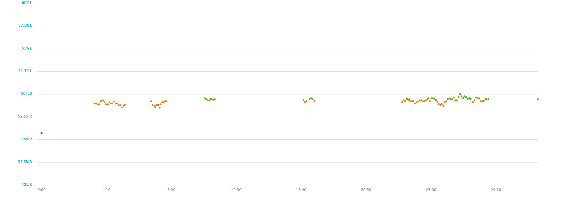

    I picked up the RunScribe Plus footpods which are currently going through beta testing and by far the biggest issue has been with connections to the Fenix 5 watch. I can see why Stryd just gave up and pulled support for the F5.
    The RunScribe datafield works without issue on almost every other Garmin watch, but we've been testing a multitude of changes to the pod firmware and data field app coding to see what can be done to reduce the dropouts on Fenix 5 watches and nothing seems to be making any real difference.
    It really is shocking that such an expensive watch can have such a fatal flaw. I've never had an issue with my GPS tracks but this ant connection (and to a lesser degree the bluetooth) problem is frustrating beyond belief.
    I've generally been quite supportive of Garmin's efforts to fix this issue but their lack of progress and general silence just smacks of shoddy design and a cover-up.
