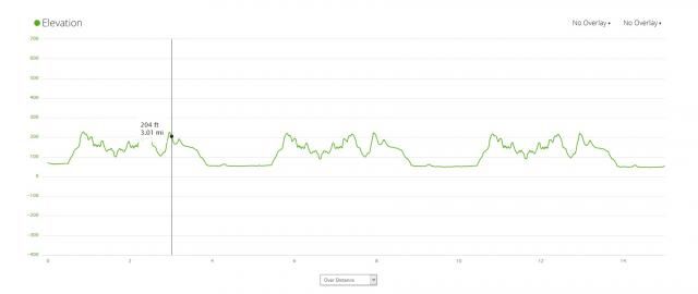

    Sometimes it drifts up 200' while keeping the overall accent/ decent correct enough and if the weather is bad enough it can also invert
    This pic you posted looks like what I get when cycling laps.
    Each lap is slightly higher than the last.
    The watch is on the handle bars not on my wrist.

    What I'm saying is that in a couple hundred walks 150 -> 2 is always correct while 2 -> 150 is never correct and always ends up higher. It's not just one instance.
    If the problem was related to the temperature I'd be getting the offset value at sea level too. It remains to be seen whether the Tempe can correct this by excluding the wrist's heat but we really don't know whether Garmin's software takes the heat into account in the first place and since Garmin needs 500 e-mails to give 1 reply, often inconclusive, we'll probably never know.
    It's not really the end of the world for just a few meters but if this error cumulates (like it seems to do in the picture of the bike loops) then it's a big problem.
