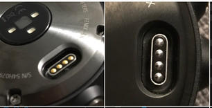

    I had a 5x with serial # 54G0001xx and it had a terrible connection to PC/usb . Garmin replaced the cable but it did not fix anything. This was in May/June. Recently I received the following email from Garmin Product support. This watch had silver not gold connector pins on the watch.
    **I refer to your recent enquiry concerning the above.
    Having previously contacted Garmin regarding your fenix 5X and it not keeping a stable connection with the PC/MAC, we would like to hear from you if you are still experiencing this symptom.
    Please contact us by phone so that we can assist you with resolving this issue. For US customers please contact us at 800-800-1020. For customer?s outside of the United States please contact your local support office.
    We would need to exchange your device.**
    The exchanged watch has gold connector pins which can be seen in the photo. 54G0612xx. The exchanged watch has a rock solid connection. Garmin has definately changed the pins on the watch.
