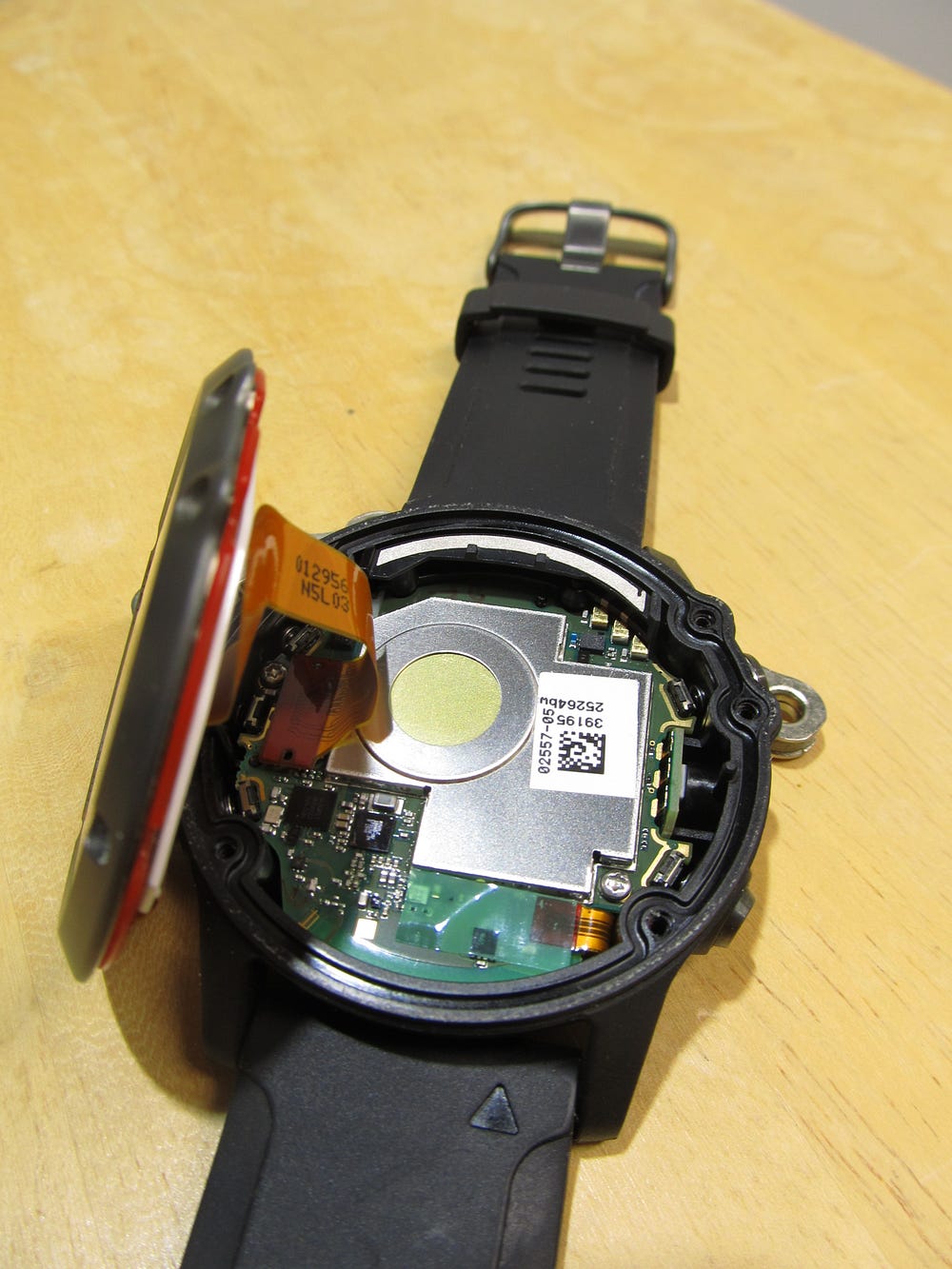

    I opened my F5 and it looks just about exactly the same as the F3HR:
    https://cdn-images-1.medium.com/max/1000/1*ML1TuHedN0Gvr2LWLJp8_A.jpeg
    The gps antenna seems to be top thing, the one on the right of this picture:
    https://cdn-images-1.medium.com/max/1800/1*qTv0XTW0z_nmkwNWHdHA7g.jpeg
    So I was thinking about looping a copper wire around the sides of the (case of the) watch with the tips either connecting the silverish (conducting?) material of the antenna or the 2 pins of the mainboard contacting the antenna.
    To do that properly I'd have to disconnect the display though (should be easy, just disconnecting the connector) and before I do that I would want to have a more solid idea of what might work and what not.
    I have seen a few ppl modding their phone gps with aluminium foil and copper wires as well, but don't want to just try crap at random and open my watch too often (also, testing is pretty time consuming).
    For now I'll just leave it as it is and think about possible tweaks ;)
    Btw, I am also a big part nerd so I actually find this fun to do as well so it's not JUST because I need to...

    @FlipStone - thanks for the teardown pics. Let us know if you can think of something but I would think (hope!) that Garmin would have had the means of doing all the possible hardware tweaking given the design constraints, although you never know of course ;-)
