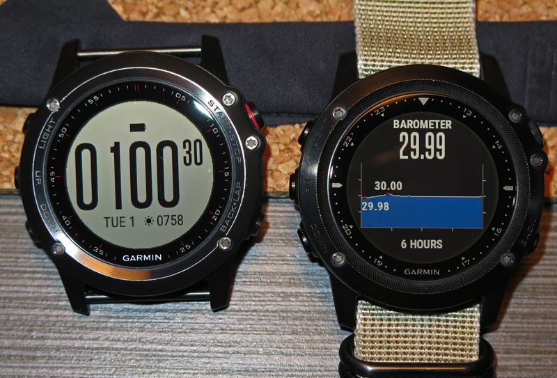

    For the fenix 3/tactix Bravo that is correct:
    When the watch remains at the same Elevation, the recorded Elevation remains constant despite chaging Baro pressure.
    HTH

  • So if you leave it at home, the altimeter does not change, regardless of any pressure changes?
    Conversely, in the presence of constant Baro pressure, Baro pressure remains steady despite changing Elevation:
    HTH

    The reported/displayed Baro pressure is adjusted to MSL (Mean Sea Level) pressure. This is the way airports (METAR) and weather stations report Baro pressure. Some other watches - Casio in particular - report pressure as Absolute pressure. Absolute pressure is simply the air pressure at the sensor without any adjustment to MSL.
    If a watch reports Absolute pressure, then your statement is correct - reported/displayed pressure will necessarily change with changes in Elevation.
    If a watch reports Baro pressure adjusted to MSL, like the fenix 3/tactix Bravo watches, then the reported/displayed Baro pressure will remain constant with changes in Elevation (assuming the prevailing weather pattern is, indeed, one of constant pressure).
    The GPS Altimeter Auto Calibration function found in the fenix 3/tactix Bravo watches is an entirely different question which is made more difficult to address simply because it does not function as described in the Owner's Manual.
    HTH
    Edit to add:
    Just to be clear, the onboard pressure sensor in the fenix 3/tactix Bravo watches measures absolute pressure to determine Elevation then calculates what that pressure would be if the Elevation were Mean Sea Level and reports/displays that. So yes, as Elevation changes, Absolute pressure does change, but the reported Baro Pressure will not because it is adjusted to MSL.
  • In GAIJIN's second set of photos he's been moving sufficiently for the watch to switch to attributing pressure changes to changes in altitude rather than to weather changes. So, if you stay still the Fenix 3 attributes pressure changes to barometric pressure changes due to weather, but if you are moving around sufficiently then the Fenix 3 assumes pressure changes are due to change in altitude only. From the user manual, it looks like the Fenix 5 is adding the option to have things like they are on the Fenix 3 (Auto) or to manually choose to lock the pressure change attribution to either altitude (Altitude) or ambient barometric pressure (Barmeter).
