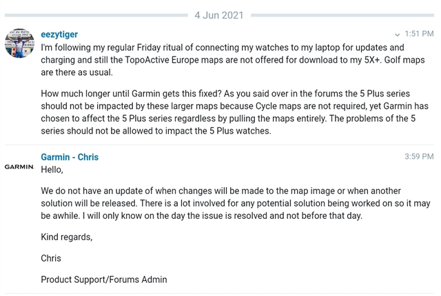

  • Garmin has withdrawn availability of the TopoActive Europe maps from Garmin Express following the shambolic release of 2021.10 maps that were first wrongly identified internally and then wouldn't fit the 5 series watches at all.
    Unfortunately I deleted the maps entirely from my 5X+ as there were some problems on my watch and now I cannot replace them at all. I can download new golf maps every day, but European maps have gone. I've exchanged messages with GARMIN - CHRIS and there is no timeframe for resolution. Garmin has screwed the pooch and are in no rush to fix their mistake.
    The crazy thing is that the maps fit on the 5X+ so there was no earthly reason to pull them.
  • Thanks for the update. My guess is for it be be 'resolved' with the TopoActive 2021.20 maps when they are released towards the end of the year.
