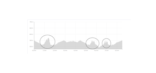

    This is profile from my watch:

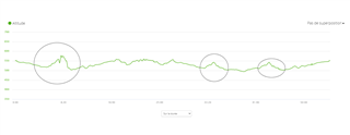

    This is from garmin connect with correction:

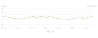

    And this from Strava wiith correction:

    We can observe some pics on the corrected profiles, these are not existing. This happened only because I'm in a mountain area, and at the pic location, I'm running very close to the montain. So with GPS error, the system believe that I'm running at really higher altitude.
    So in this case, I should not use GPS, barometer from the watch is really better.
    And when I'm making small calculation with correct altitude, it seems in fact that the watch is very close to the reallity.
    And for you iinformation I'm using auto-calibration during all activity, I will try next time on same run to unactivate.
    Thanks!
