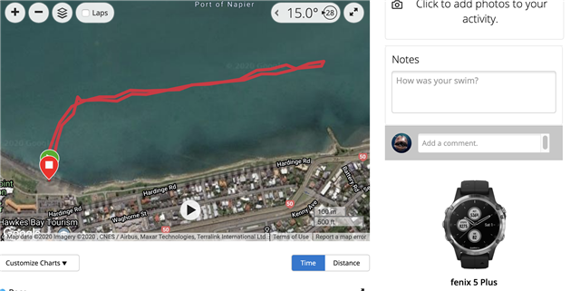

  • Ideally you'd have an accurately measured distance but that's not always possible of course so hard to say whether your GC distance is grossly out, unreasonably out or ok. Few of us are able to swim in a dead straight line so estimated distances from a map could be off by a reasonable amount too. My swim distance over the 2000m buoyed course can vary by 200m or more depending on where I start/stop the watch, whether the tide is in or out, and whether I can see where I'm heading due to waves etc but it usually is less than 10%. Here's some examples from swims earlier in the year with my 5+:
    A good track - that was me swimming off course as the sea was rough and hard to see sighting points
    then this...which was pretty ordinary - extended swim an extra 500m (or should have been). And it wasn't me swimming all over the place either lol!
    then back to being reasonable again

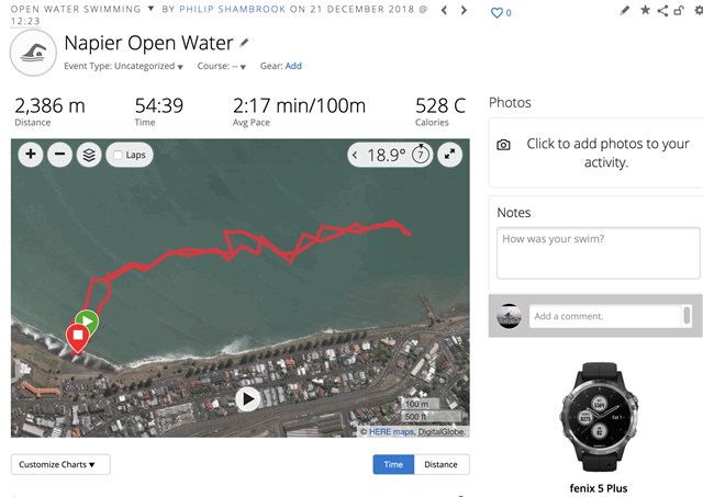

    But going back to December (found this while looking for something else) it was diabolical...

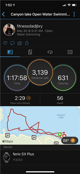

  • Former Member
    0 Former Member over 4 years ago

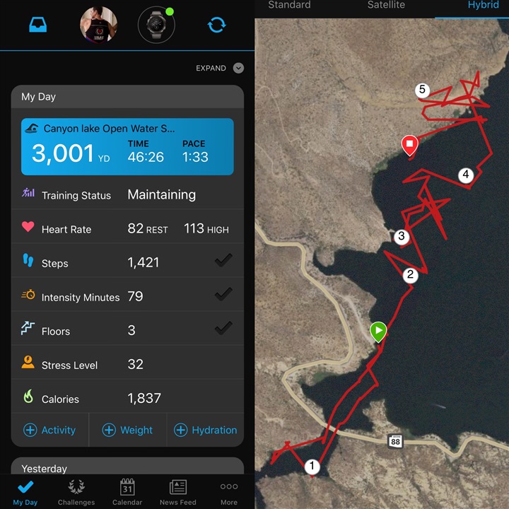

    That’s actually a fantastic reading! From my experience, the fenix 5x plus is good for around 1500-2000 yards and then it begins to go bonkers.
    This swim was today, but it was really around 2,000 yards.
    the one from May 30th last though was pretty good. The watch started to go nuts a couple times but overall did what it was supposed to.
     Garmin has been no help regarding this.
