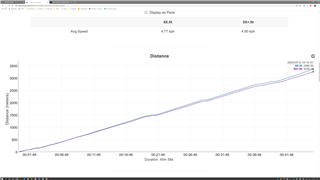

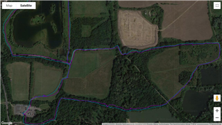

  • Today I compared 5X+ with GPS only to 6X Pro Solar with GPS and GLONASS. Both got the start/finish point correct to within about one car length. 6X was on the left wrist and 5X+ was on the right. Although I am not 3m wide, it is interesting to observe that most of the time the left/right separation is reflected in the two tracks created. 6X is blue, 5X+ is magenta.
    The 6X did a little better overall, especially smoothing out the classic 5X+ wobbles, but overall they both held up well, even going through woodland. This was a dog walk, so some stop/start at times, especially through the woods when the dog goes on the lead.
    Distance differed by 102m after 3.3km, shown as a gradual separation over time/distance rather than anything jumpy. That's 3%, reflected in the average pace discrepancy, more or less. That's not so good, but seems typical in recent comparisons. I'm guessing smoothing algorithms are at work here. I have no idea which distance is more correct. Maybe one is 1.5% too long and the other 1.5% too short. I can work with these numbers though, for dog walks. :-)
    By the way, I am running beta 10.72 and GPS 2.60 on the 5X+ and beta 7.81 and GPS 4.10 on the 6X.
