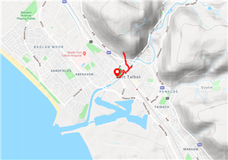

  • The flat parts before and after the 3 ascents/descents were actually flat. The terrain at Port Talbot is pretty remarkable - totally flat for the first 2 km from the ocean, and then suddenly 3 small hills with 20-30% ascent rate pops up. It is easiest to see if zoomed out a bit:
  • I'm still perplexed as to what happened during your second climb and can't offer a sensible explanation.  I guess that puts me in the $hit happens camp and so not sure we'll figure it out.  Looks like a great area and any spot that has oceans and hills is speaking my language.  My only other question might be how does it look in Connect Mobile?  Have you examined the data there?  Don't use GCM myself so not even sure if your response would be of value.  Just another check point.
