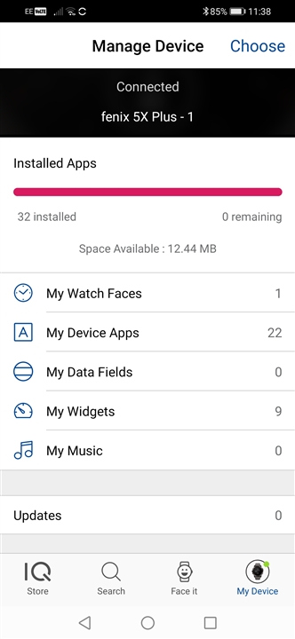

  • My Fenix 5x plus used to have 2MB.... but about 3 months ago... it changed to about 16MB I think..... through a software upgrade..... Have a look at this picture......
    Maybe you're watch didn't get the upgrade?...
